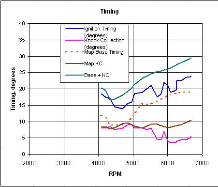

wow do WRX's hate running at 12.0 lol
03WRX
Mods:
UP/DOWN/TBE... thats it
Tune notes:
16 psi
Stock timing base and KC
Target 12.0:1 A/F richest
And how the crap am I getting over 5.0 load in 3rd gear!?
4082 3.57
4204 3.79
4328 4.31
4475 4.8
4699 5.05
4851 4.63
4954 4.5
5047 4.59
5270 4.63
5396 4.66
5522 4.58
5703 4.49
5809 4.52
5891 4.4
6014 4.3
6073 4.33
6239 4.22
6260 4.13
6383 4.12
6533 4.03
6643 3.99
6684 3.9
