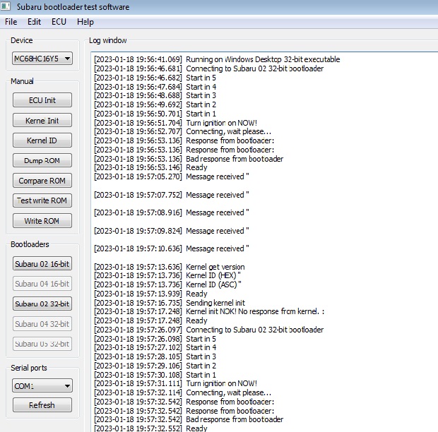

hello everyone, today I managed to read the firmware from my forester cs using a vag kkl cable(ch340). but it turned out only fastecu, subaru bootloader from the first post gives an error. win7 32
fastecu write test - ok
tomorrow I'll try to write it down, today I was afraid to block the ecu
where can i find defs for romraider?
Thanks for your work, it's a big job
