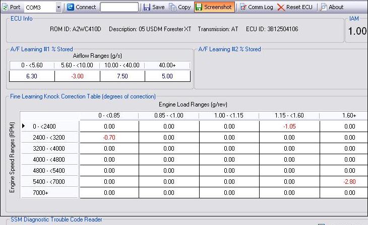

Here are the screenshots- for some reason they come out 5 pixels too tall to upload
Oh yeah, its an 05 FXT AT
