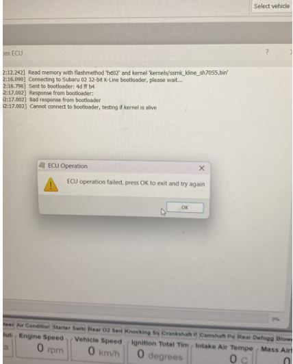

Hi.
connect error JDM Forester XT / Cross Sports

cortin wrote:
Hi.
Im getting the same error as above.
Any ideas?
Cheers
