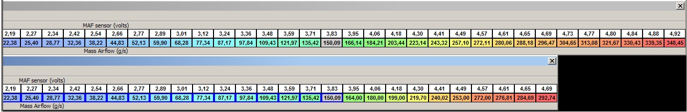

MY07 FXT, hitting maf limit and running rich beyond
I noticed STI has bigger resolution table, extending beyond 4,69, wondering if there are some wayarounds to achieve this on FXT
my other two options are either lean on target AFR beyond what MAF is scaled it, which is half-ass way of doing it, or rescaling voltage increasing the values, meaning I will loose accuracy in low/mid area values
looking for a more elegant solution, if there is any
