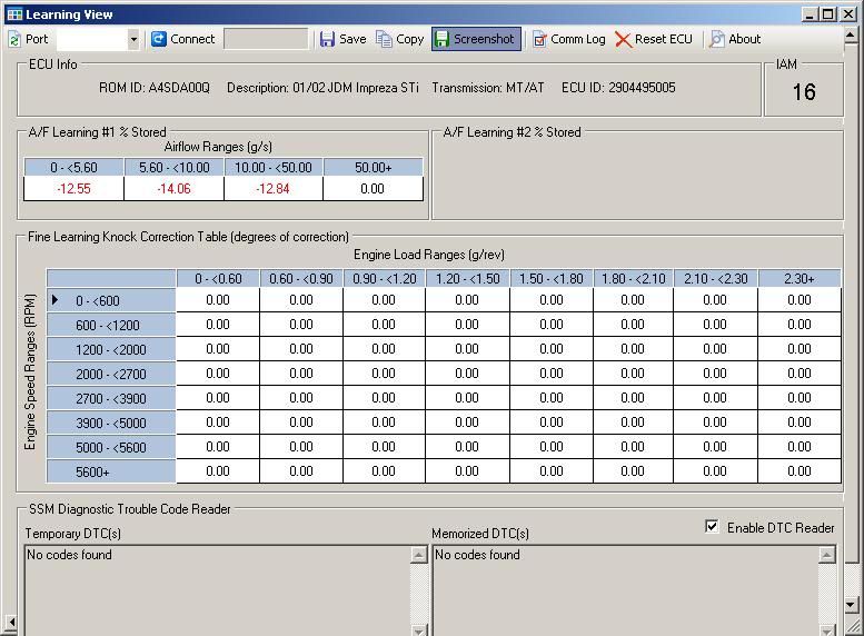

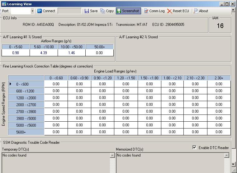

Just thought I'd post up my early results and a thanks for this guide, here was one of many "before" snapshots. After hitting "Update MAF Scaling" button in RR, I found that no matter what I did my rom would not save with the new values. Possibly something I'm doing wrong, but I copied the table to excel along with my "trunk" table (to make sure the values were different) and updated my rom manually in ECUflash. I've just downloaded several of the different CL spreadsheets for next time - the "after" screenshot is only after about 10 minutes of driving so I'll leave this tune in for another few days before going through my next iteration. Will probably also change my airflow ranges too as I now understand the difficulty of getting reliable data from between 5 and 10 g/sec.
Before
After
