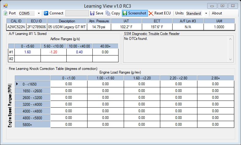

Joined: Tue May 14, 2013 3:42 am
Sooo, I just did this because I have -15.00 across the board and I'm already 'tuned' (see thread here herehttp://www.romraider.com/forum/viewtopic.php?f=15&t=9595) and now I have a few questions.
When I went recording, I was all highway for 30 minutes, then drove around the city in 30 minutes, and finally made rounds around a parking lot at 5mph for 15 minutes with idle. I did this all in one shot without stopping the record button.
-^Was that ok ? ( I did pause on dramatic throttle responses)
-When I updated the maf sensor, I didn't make any breaks, but instead small increments like 1.10-1.20 update, 1.20-1.30 update, etc. I already had a "nice line" with the exception of the low and high ends.
-Does maf scaling in cl affect any other part of the tune? I'd think not since these values (.9 to 3.0) are all under idle and cruise.
End result looks promising and hell of a lot better than past learning views. (I have logs attached) but we shall see ?
If I'm headed in the right path, then Ill continue for better accuracy.
