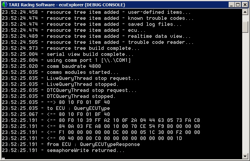

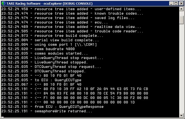

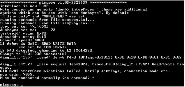

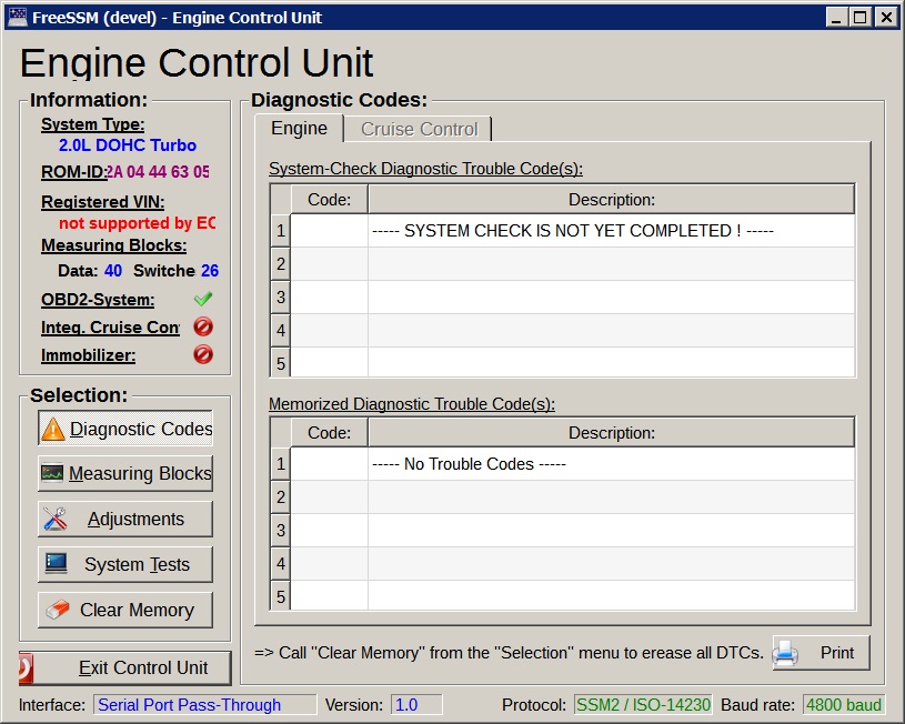

Posts: 278
It won't connect. It's not usual Denso K-line ecu. EcuFlash can't even read it. But FreeSSM connects without a problem.
Other tool with debug window, that connects also:
Maybe you can analyze stock rom, to find connection properties?

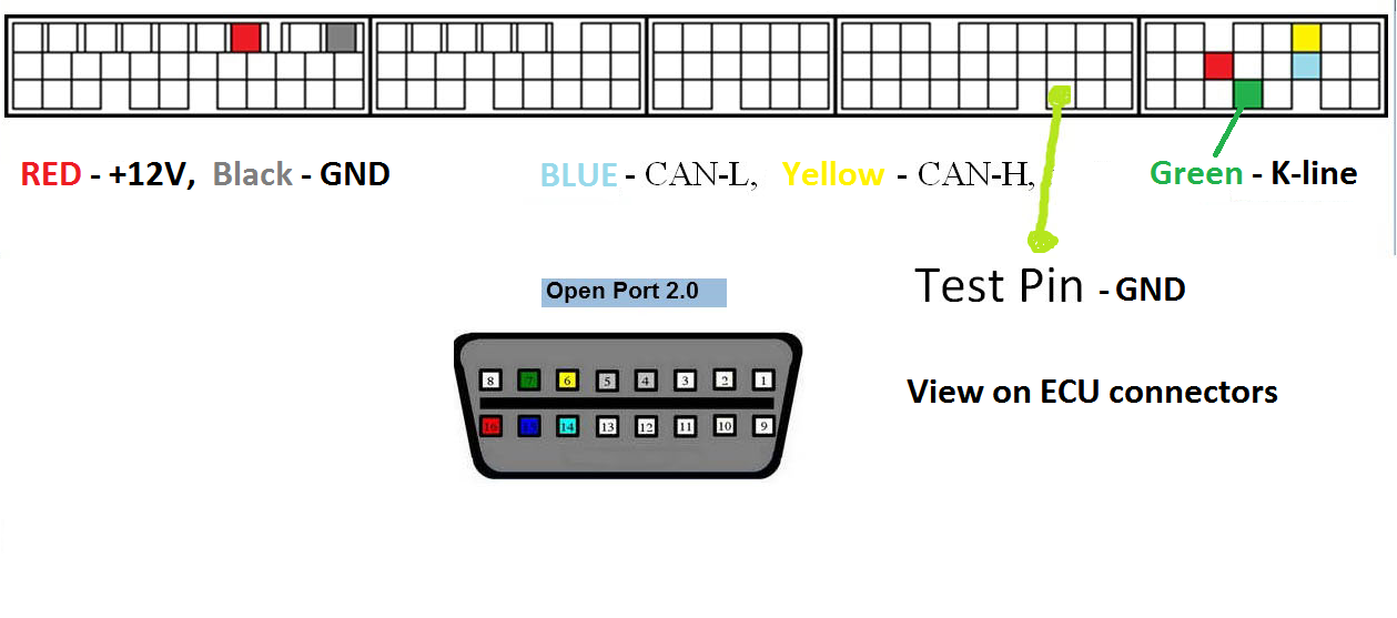

I have JDM Forester Cross Sports ECU (2A04446310) on bench which is the same series ECU as SergArb have (2A04446305). These are Densos early 32bit DBW ecus with sh7055 that uses 16bit connector and layout on pcb. ECU init command (0xBF) will respond from terminal but startCommunication (0x81) will not respond at all. I can test different commands with this ecu straight from terminal if it helps any.
And these have also 6-pin line end connector, that I think needs to be connected while programming, but I'm not sure do those lines need to be grounded or voltages in it...

It can be read and written on the bench via CAN lines. But it's not opensource software. Universal Denso CAN bootloader, works with all SH7055/58 Denso ECU's(Not only Subaru, many other brands too).
I have some pinouts:
