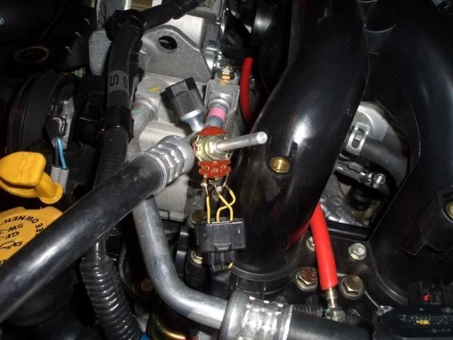

Hello fellow romraiders! I have a diy WB02 kit that a purchased from 14point7.com a few years back that has 2 voltage outputs that can be scaled to your liking. The only problem is I cannot exactly match up the time stamps on the wb02's log to my romraider logs for obvious reasons. This got me thinking a few nights ago about the different inputs that can be logged via the factory ecu with the romraider logger.
In an ideal world the factory ecu would use a voltage output from the factory front 02 sensor so you could easily replace it with a aftermarket unit that mimics it's voltage output based on AFR or lambda. But as we know the ecu measures the mA output to of the sensor to figure out AFR. This in turn makes replacing the stock sensor with a aftermarket unit impossible. Most people that are running modded subies that I know have removed their TGVs which brings up an interesting point. The factory TGV angle sensors, to my knowledge, use a +5v reference to figure out the angle of the TGVs much like the factory TPS does. So in theory if your TGVs are removed you now have 2 open +5v inputs into the ecu that can be logged via romraider!
Now I have yet to test my theory, but could anyone see this causing a problem? I am not sure of the logic behind the TGV fix in romraider.. is it just to curb a CEL and codes? If someone could enlighten me that would be fantastic. My guess is that the ecu uses the angle sensors in a closed loop fashion to figure out the correct duty cycle for the TGV solenoids. Is a sweeping 0-5v afr signal going to make the ecu try and compensate for something because it now thinks the TGVs are moving all over the place? I figure the worst that could happen is I cook the ecu by applying too much voltage or something along those lines (which would suck!). But as long as the wb02 doesn't output more then 5v I really don't see it being a problem. Looking over the wiring diagrams from a MY02 WRX it looks like B13 (left) and B23 (right) are the 2 separate inputs at the ecu.
Should I try it and see what happens? I am rather nervous seeing as how I can't afford another ecu if I cook it. I might wire up a potentiometer from the B9 5v reference that powers the TPS and the TGV angle sensors just to see what happens and if I can actually log a change in voltage via romraider. If everything works and I can in fact log my wb02's output voltage I would then have to make some type of spreadsheet to turn those voltage perimeters into usable AFR. I could see this being just as effective as using a Innovate or AEM wb02 just without having to have another cable plugged into my laptop.
Any feedback would be great! Thanks again to the community for making all of this open source subie tuning possible! :twisted:

It is not disconnecting the solenoids I am worried about. It's the fact that I will be giving the ecu a varying 0-5v signal from an external source. I really don't see too much harm coming from me doing this. I think I may just be a little paranoid :roll:

External 0-5V could not be dangerous for your ecu inputs.
Your ecu routinely sees those marginal values when power or ground wire of TGV sensor is broken\disconnected.

I can only confirm that attaching a pot to a TGV connector works like you'd expect...
I think the odds are very good that you plan will work, but it would be good to confirm that there is no voltage between the WBO2 ground and the ground you find on that connector. Ditto for the 5v lines.

It works :twisted: I am working out the details of the spreadsheet to change the voltage to usable AFR. I'll post up a log tomorrow :mrgreen:

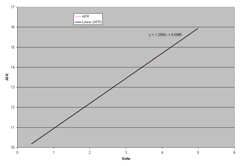

Quick update: So I found out that the ecu rounds the voltage input to .02v so I am losing a bit of accuracy. Alright now I am trying to figure out how to make the logger output the AFR value. I have my JAW setup to output volts to afr as follows:

I got these figures by putting 14.7 @ 4v and using 0.8v/AFR in JAW Edit to give me good resolution with the factory ecu. Now how to I use these values to get the logger to see afr? using y=mx+b it seems it should be something like y=0.8(x/50)+0.38 correct? The x/50 came from the logger xml. It seems it divides the raw ecu value by 50 to output the voltage value. And 0.38 is the lowest voltage that the wideband outputs. BTW math was never my favorite subject so bear with me :roll:

In Excel you can plot the AFR over volts. Then add a trendline and set the option to show the formula on the graph.
Using the default settings in JAW Deploy I get: AFR = 2 X volts + 10
The results I got for your data is: AFR = 1.2505 X volts + 9.6985
as show in this graph
Now in the logger.xml def file you need to change the formula for calculating the ECU data for the Tumble Valve Sensor you are using.

The ECU spits out a single byte between 0 and 255 so the x/50 converts the byte to volts. That's the value you need for your formula. You could also refine it to "x*0.02501+9.6985".
