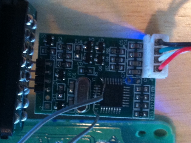

For the USB->Serial device, there are many options. I used a ebay vag-com cable I picked up for about $20. You can also get a DLP232 chip, I have one from Digi-key, I think it was about $25. On the thread referenced above he shows how to hook that up. I’m working on adding the one to the breadboard I have to make it one neat package instead of what I have here.
After opening the vag-com cable and using the datasheet for the FTDI chip inside the vag-com cable, page 6 shows the pin diagram:

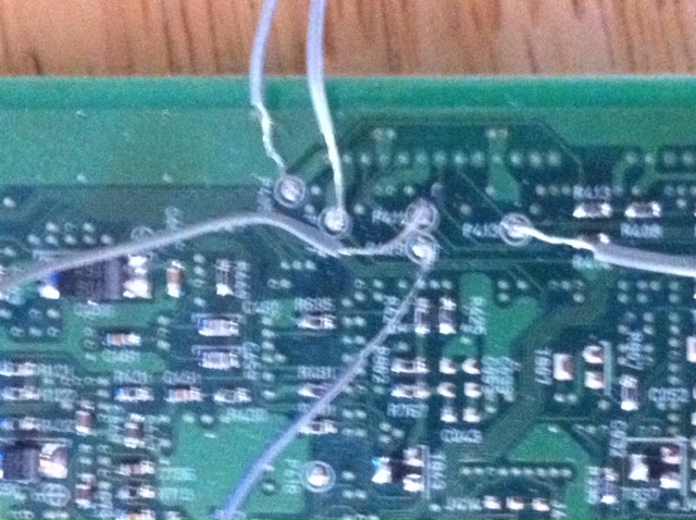

Make the connections necessary to the ECU PCB.
P409 is connected to pin 25(TX) of the vag-com cable, and P411 is connected to pin 24(RX) of the vag-com cable, just like in the Tactrix schematic, I did not need to invert the vag-com signal.
In order for the vag-com cable to work properly, I had to pull pins 24-25 off of the vag-com’s circuit board, but kept them attached to the chip. I also had to power the vag-com cable through the OBD2 connector. I picked up a few male OBD2 connectors at the local PicknPull and powered it with the same 12V that powered up the ECU.

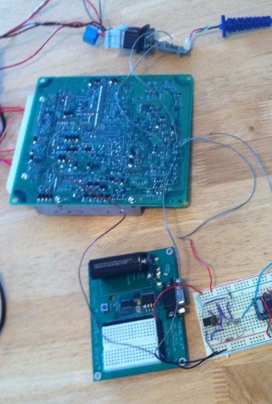

Also you’ll need to power up your ECU, most ECU’s have different pins for power and ground. Reference a service manual to be sure you are using the correct pins, I powered up the power supply pins and backup power and ignition switch pin in my ECU, and connected the power supply grounds.
Good to go, right? After firing up EcuFlash with the alternate flash mode option checked in the options menu and the stock ROM for my ECU loaded up(Tactrix did that, I felt it was good practice), It did not work the first few dozen times, I ended up supplying a 5V power source to P405 and the timer circuit separate from the 12V power circuit. EUREKA! It worked.

Redundant? Most probably, but hey, it worked :D The 5V source is from a BasicStamp Homework Board that comes in a “What’s a microcontroller” kit from RadioShack, you can also get at the Parrallax website. I highly recommend this kit for people with very little electronics know-how (like myself), it’s really opened my eyes on how a microcontroller works and basic programming syntax. However, any 12V and 5V source should work.

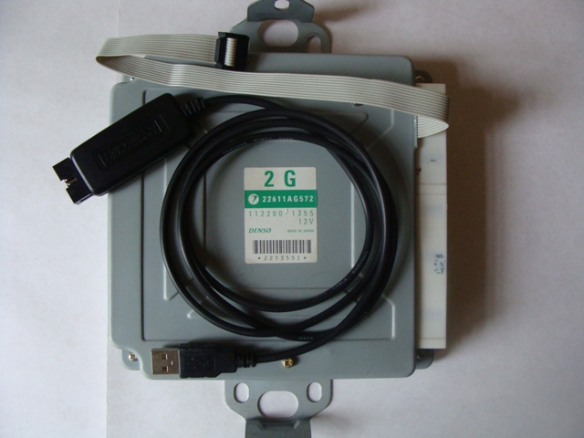

1. FDT is a full featured unsupported version. The limitation is that it is artificially slows down writing to a flash memory ( as like it is done at 9600 bps, about 20min/1 MB flash). ROM verification\reading is done at full (57600) speed.
2. Tried to flash 7055F based ecu about 300 times (100 is promised by datasheet, 10000 evaluated later).
3. Watchdog is a must for Denso ecu.
4. You are to have a complete dump. The whole ecu content is erased after flash mode is entered.
5. You are free to create the initial bootloader on your own and to make a complete ROM image.
6. Immo lives outside the SH chip. Find something like 93с66 chip probably connected to SCI3 port of SH7059.
7. Ask for those who can overcome disabled AUD interface in order to get the ROM or reinvent a bootloader.

I use to do this way.
You are to solder just Gnd/Watchdog/Rx/Tx wires for programming and connect the programmer and the ecu back to the car wiring ( in that order ).
Do not forget to use protective resistors about 5kOm/1kOm/5kOm for Watchdog/Rx/Tx.
Added:
- and make proper wiring for FWE and MD1 circuitry in order to enter bootmode.
Added:
The schematic from tactrix doesn't have protective resistors on the Tx & Rx lines, and only a 1k ohm resistor or the Watchdog line. Is it because we are powering directly from the vehicle? Or is it an added safety measure?
