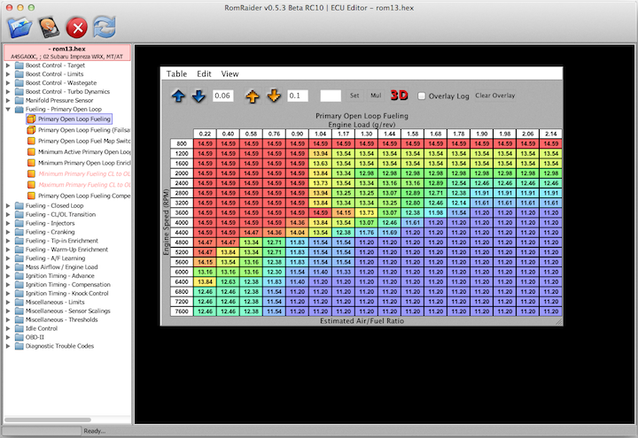

Can you provide a screenshot of the table title bar problem?
 Post subject: Re: Getting RomRaider running on Mac 10.7.1 & Tactrix 1.3U
PostPosted: Tue Sep 20, 2011 12:54 am
Joined: Wed Apr 20, 2011 2:22 am
Posts: 93
Location: Kitchener, Ontario, Canada
Sure, here you go. Captured a couple of images of the primary open loop fueling table.
First image is after I managed to move it. Second image is how it initially pops up in the top left.
File comment: After moving.
File comment: Before moving

DannyW wrote:
EDIT: Well, right clicking build.xml and selecting Run As -> Ant Build ... and building the "all" target seems to build everything. The zip files that get created seem to be working. Maybe these points should be for a different thread about romraider mac os support...
Was just about to say that, but you beat me ;)
Also in the screen shots, the area where you need to use to drag is 2 pixels tall, right at the edge of the top of the window. The tip of the pointer has to be right on the edge of the window.
