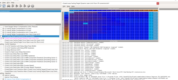

This is great. Just an FYI, I can't seem to change the values in this table. I tried incrementally increasing the value and manually editing the cells, but it goes back to 14.7
