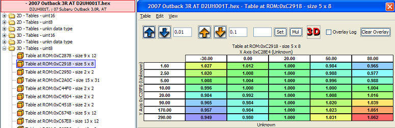

If I open the 3D table at 0x2C918 (5 x 8), the Y axis has a big random number in the first value, and zero in all of the rest of the values.
If I use EcuFlash to create a new scaling (call it "raw float") with a float data type, no conversions, and format of "%.1f" then the following series of numbers appears on the Y axis:
1.6
2.5
5
10
20
90
170
290
By 'scaling' I really meant data type. EcuFlash considers data type an attribute of the "scaling," so I was thinking in those terms. But, I was barking up the wrong tree anyway...
Here's the XML for the scaling that I created:
<scaling name="Raw Float" units="units" toexpr="x" frexpr="x" format="%.1f" min="-1000" max="1000" inc="0.01" storagetype="float" endian="big"/>
Here's a scaling from a randomly-selected 3D table:
<scaling name="UnknownX Axis 0xC061C" units="Unknown" toexpr="x" frexpr="x" format="%.2f" min="-2.14748e+09" max="2.14748e+09" inc="5" storagetype="float" endian="little"/>
The X axis of the table at 0xC061C had a bunch of random numbers in it when I opened the ROM, but the numbers look reasonable when I apply my "raw float" scaling to it.
Do those axes look reasonable for you guys when you just open the ROM?

If I open the 3D table at 0x2C918 ( 5 x 8 ), the Y axis has a big random number in the first value, and zero in all of the rest of the values.
1.6
2.5
5
10
20
90
170
290
I assume you mean 0xC2918?
If so this is what I have on my screen:
It looks like a temperature and load related compensation table.
Are you staying that the endness value is messing up the axis interpretation? All data in the ROM is big ended. I'll have to fix that in the def output (OP) as it never seemed to make a difference on my system.

It might be related to me using EcuFlash and you using RomRaider - probably EcuFlash is just choosing the wrong default when the def doesn't include it. You should try EcuFlash for this stuff, if you haven't already... it opens ROMs way faster that RomRaider, which is handy when you're playing with definitions.
I'm guessing that's the IAT compensation table for the MAF sensor.
 Post subject: Re: RAW Table dump for 2007 Outback 3.0R-AT CALID: D2UH001T
PostPosted: Wed Aug 18, 2010 6:43 am
You are quite correct...
