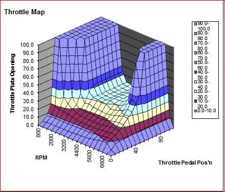

I plotted the dbw table and this is what I got from the stock map. Its pretty odd for stock values.
This is with sport sharp and target throttle plate position maximum. Typically column for 1 ratio should be all at 100.

 Post subject: Re: 2011 JDM Impreza STi AT CAL ID: AZ1J500J (7432744007)
PostPosted: Mon Aug 01, 2011 10:45 pm
Posts: 7314
So what seems to be wrong? The 'Requested Torque Accelerator Pedal SIDRIVE' are wrong or are you expecting target boost tables per Si mode?
PostPosted: Mon Aug 01, 2011 11:09 pm
Joined: Mon Dec 15, 2008 3:12 am
Posts: 672
Location: The Philippines
I wasnt expecting less than 100 values for 1 ratio column. So there's a big gap in the middle of the graph where it should be 100. The ff are all from max. Typically you see something like this (from legacy gt AT AE5F301C) Take note that ratio 1 colume has 102.4%
Here's the dbw for the stock forester xt 09
The values in target throttle plate position tables for AZ1J500J (between 2800 to 5600 rpm) is not what you would normally expect in the rightmost column (1) of Requested torque to requested torque base ratio.
