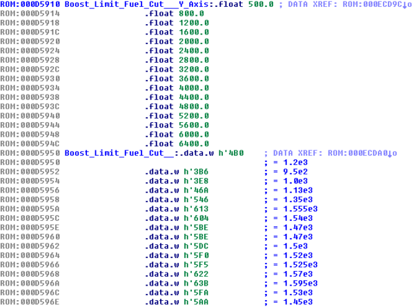

 Post subject: Re: AE5Z321V USDM MY19 STI ECU B22A933107
PostPosted: Wed Jun 22, 2022 6:07 pm
Posts: 7314
The Boost Limit (Fuel Cut) table as defined displays the correct values.
The raw data from the ROM looks like this, the same as viewing the table in Raw values.
File comment: ROM data
File comment: RR raw values
The axis values are not defined correctly, it should be Engine Speed (RPM).
I realized that my table axis are wrong with the current GitHub definition...
File comment: Wrong upper Axis (Atmospheric pressure up to 123PSI?!
For some reason there were 3 tables with almost the same name in the definition, I figured out that mine uses the "Boost Limit (Fuel Cut) " noticed the 2 spaces at the end...
File comment: Better axis name and scaling
The table had "Atmospheric Pressure (PSI)" as the Y Axis, which should have been "Engine Speed (RPM)", as you pointed out. The other Axis was correctly labeled and already converted to "PSI Absolute", which is much easier to work with than "Raw Value".
I was able to fix it, with this code :
    <table type="2D" name="Boost Limit (Fuel Cut)  " category="Boost Control - Limits" storagetype="uint16" endian="big" sizey="15" userlevel="1" logparam="E52">
      <scaling units="psi absolute" expression="x*.01933677" to_byte="x/.01933677" format="0.00" fineincrement=".01" coarseincrement=".1" />
      <table type="Y Axis" name="Engine Speed" storagetype="float" endian="little" logparam="P24">
        <scaling units="RPM" expression="x" to_byte="x" format="#" fineincrement="50" coarseincrement="100" />
      <description>Fuel cut will be activated when actual boost exceeds the corresponding threshold in this table multiplied by an atmospheric pressure multiplier.</description>
