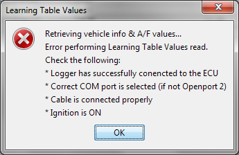

Hi guys, can someone explain me what i am doing wrong ?
When i want to look at the learning view of my carberry rom in romraider with SDlogger-rev1.8.xml definition file it shows me this :
 Post subject: Re: CarBerry ROM - EcuFlash Definitions
PostPosted: Wed Mar 29, 2017 3:28 pm
I use a separate program for that on this rom
http://www.romraider.com/forum/viewtopic.php?t=7397
PostPosted: Wed Mar 29, 2017 6:41 pm
Joined: Fri Jan 08, 2016 3:04 pm
Posts: 30
Yes separate program works...
But i am very interested what is cause of that error ?
