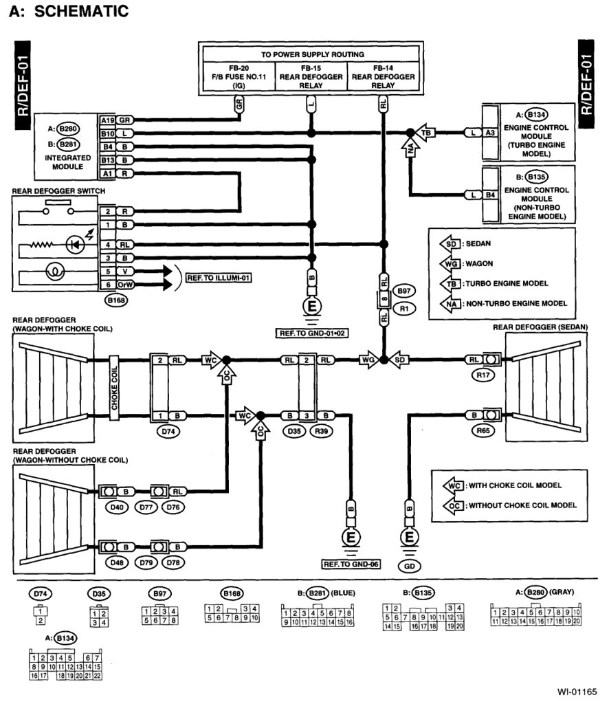

kbaldi_29
Post subject: Re: CarBerry ROM - 16bit Speed Density Project Posted: Tue Sep 13, 2011 1:39 pm |
| Newbie |
Joined: Tue Mar 15, 2011 12:43 am Posts: 74
here is a diagram of the system, dont know is by removing a relay or fuse will lose the output signal to ecu too, this timer might be set by the module in the diagram, not sure about it but could be. if what you are looking for is disable the heating element on glass i would say is just easier to unplug it from its connector it self (B97), if is not what you meant or need it to know let me know

Carbibbles
Post subject: Re: CarBerry ROM - 16bit Speed Density Project Posted: Tue Sep 13, 2011 3:03 pm |
| Experienced |
Joined: Tue Aug 30, 2011 7:17 pm Posts: 900
Actually it is possible to use the defogger pin on the ecu without affecting the defogger's function. The pin on the ecu is A3 (Connector A pin 3 "A:B134"). You could simply snip the wire going into A3 and wire a switch to it to ground the pin when the switch is on.
The defogger button on the dash would no longer control the pin but it would still function the window defogger system as stock. Then you would just use your newly wired switch to control any ecu feature that you select to be activated with the "defogger switch".
Also, im looking into using auto trans inputs. There should be a couple pins we can use that would normally be used by the AT.
| Top |
kbaldi_29
Post subject: Re: CarBerry ROM - 16bit Speed Density Project Posted: Tue Sep 13, 2011 3:36 pm |
| Newbie |
Carbibbles wrote: Actually it is possible to use the defogger pin on the ecu without affecting the defogger's function. The pin on the ecu is A3 (Connector A pin 3 "A:B134"). You could simply snip the wire going into A3 and wire a switch to it to ground the pin when the switch is on.
Also, im looking into using auto trans inputs. There should be a couple pins we can use that would normally be used by the AT. you are right, so its actually will be possible to have different switches to control different functions? for example, one switch for AL other for launch control?

MConte05
Post subject: Re: CarBerry ROM - 16bit Speed Density Project Posted: Wed Sep 14, 2011 1:00 am |
| Newbie |
Joined: Mon May 12, 2008 3:02 am Posts: 33
I can tell you that the pin that you are trying to ground with a switch in between will work if you are using pin B12. I did the same thing to get Group N map switching to work on my JDM ECU running a 207 since my chassis harness is still a USDM WRX despite having a JDM ECU and a JDM Engine. I made a switch so that I can turn on antilag/Group-N mode on a whim. Works incredibly well. I'm surprised I didn't post anything on RR about it. I know I posted up on the Group N thread on NASIOC. You should have hit me up as well, I had a couple extra ECU pin pigtails leftover that IA Performance sent me (the same pigtails they use for their AVCS harnesses). http://www.youtube.com/watch?v=lvvE-BFq-LwI am very interested in this carberry ROM. Once I get my cable back from a friend that I am letting borrow it, I'll be checking it out.
