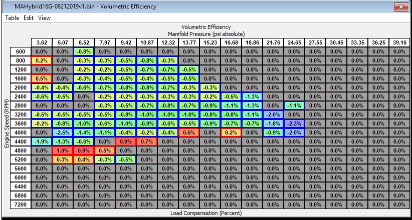

PostPosted: Thu Aug 22, 2019 1:41 pm

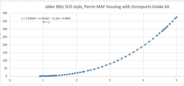

edit: yes, I will post the ROM when I've completed boost related tables and timing, we're almost done on fueling.
unknown intake, scaling wasn't perfect, you could see it wasn't clean enough.

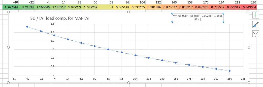

decided to try SD off the MAF IAT, with doing a fresh third order polynomial for SD/IAT comp, centered around 68F to match the centered temps of the MAF IAT g/s compensation table.

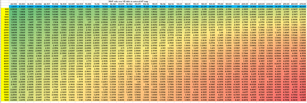

Then I redid some of the other IAT compensations to be re-centered around 68F and had my way about scaling the VE table without the use of MAF based airflow readings. just logging MAF volts.
to which I then scaled the MAF.
Not only can you run decent speed density based off the stock IAT location of the MAF sensor body, but you can do so AND scale an unknown intake from that data.
If you can do it well enough, you can do it backwards. or something.
I'll release the ROM when we're done. We're nearly done, I'd like to keep adjusting wastegate duty / target boost and timing.

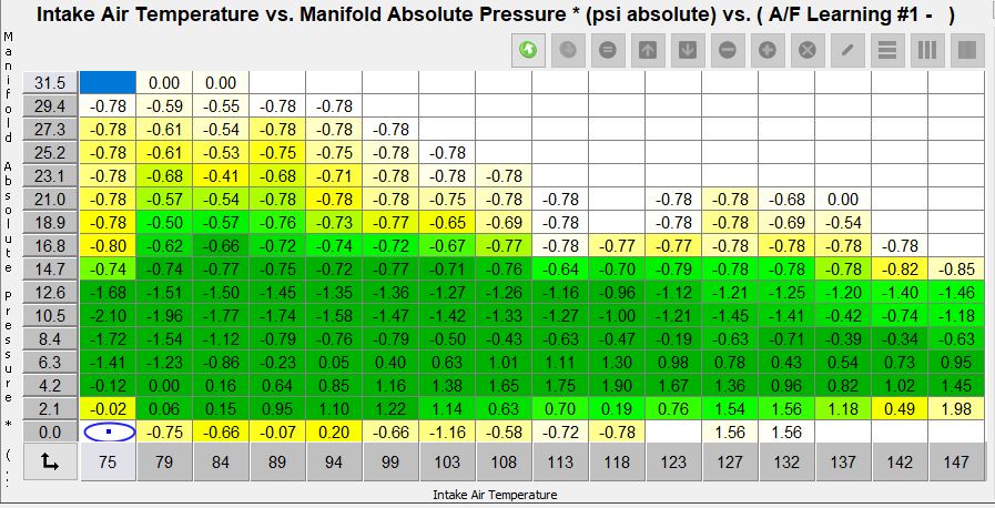

 Post subject: Re: MAF/SD BLENDING based off MAF IAT
PostPosted: Mon Aug 26, 2019 1:58 am

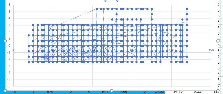

While the images in the zip file are worth a look, here's some more.

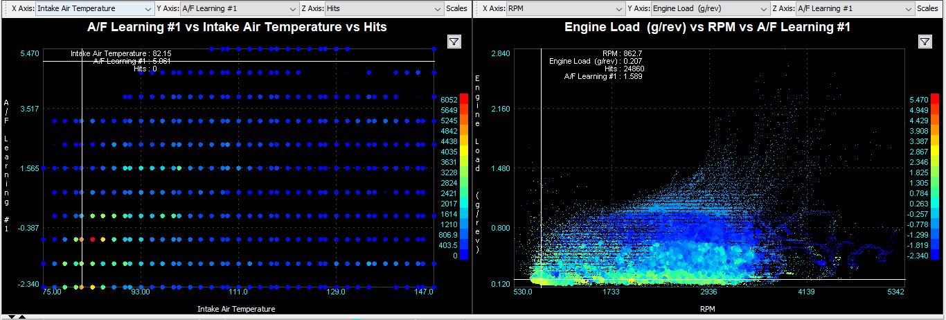

LTFT (current) over IAT, from the closed loop portion of three hours worth of logs, from the data posted in the previous zip file.
What this tells us, is that there isn't an appreicable LTFT correlation to IAT change. It does as it does.
Also in the log, you can see how IAT temp can change a couple dozen degrees over a short period, and to see fuel trims doing consistent sort of things for constant throttle, and repeatable thresholds for throttle change, and none of that is specific to IAT.

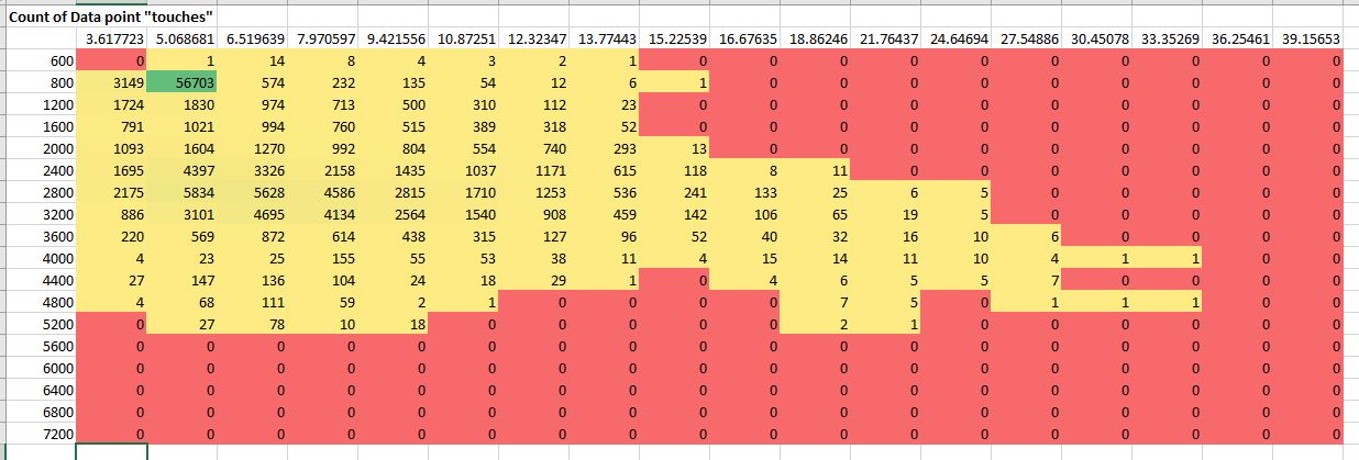

File comment: CL, and OL data where TPS > 90%
File comment: next time it might be more negligible
File comment: sweet sweet polynomials
File comment: that's like 130,000 data points

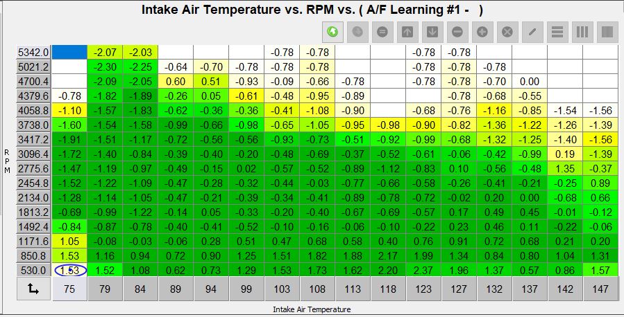

Previous post's images are data taken from about half of the data acquired off the same revision, these images revolve around just the closed loop data (I didn't filter any closed loop data out) of all the logs provided, which just closed loop totals more than 219,000 polls. Average is 74ms.

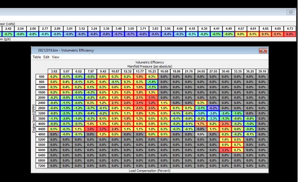

getting even cleaner
there was -0.7 to -1 degree of FLKC in some areas, so I pulled that.
wish I could drive it.
When we're all done I'll post the whole ROM and go over the process. I think we're almost done? Broke second gear and it's down for the moment.
File comment: comps
File comment: fueling error over 280k+ lines of valid data

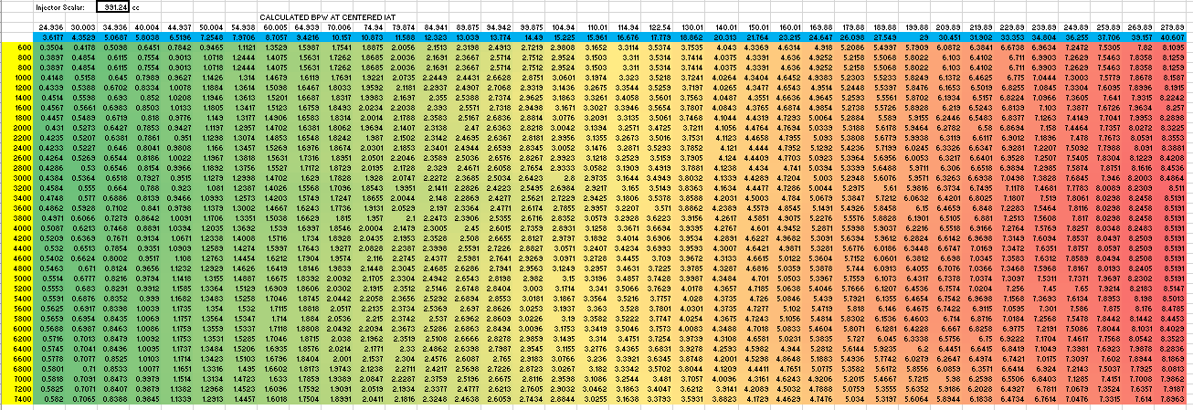

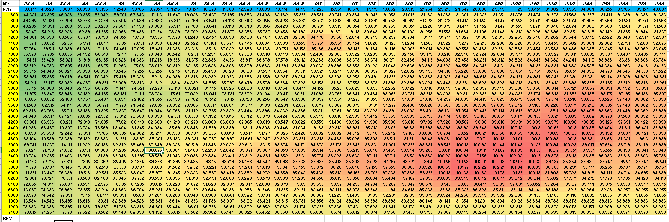

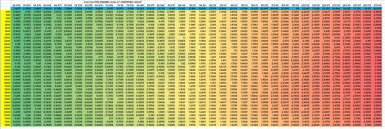

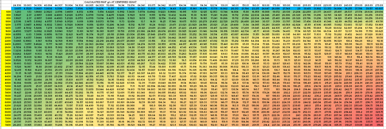

PostPosted: Sun Oct 06, 2019 12:13 am
4EAT Carberry USDM EJ205
two offset MAF scales blended 50/50
two offset VE tables, blended 50/50
MAF and SD are blended 50/50 always
stock recirculation valve
MAF IAT g/s is centered at 86F, like the SD/IAT table is centered at 86F
edit: while related to the original post, this one has the IAT sensor on the underside of the intercooler, in the end tank before the throttle. noting that with the one setup, there is just one VE table and one MAF scale, and the IAT is in the MAF housing.
File comment: base pulse width (target for stoich, without lambda compensations) @ 86F IAT
File comment: MAF sensor voltage, at 86F IAT
File comment: mass of air, grams per second, at 86F IAT
File comment: mass of air, grams per engine revolution, at 86F IAT (post intercooler, pre-throttle)
File comment: ve as interpolated at MAPxRPM points between two tables
