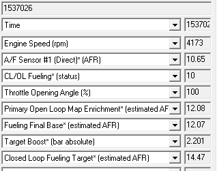

2. I'm trying to figure out how to manage AFR by editing the table Primary Open Loop Fueling (Anti Lag Conditions Not Net). For the test, I set the AFR 12.06 in the boost and rpm ranges that I use. However, when writing logs, I see real AFR 10.5, despite the fact that the values Fueling Final Base (AFR 12.08) and Primary Open Loop Map Enrichment (AFR 12.07) contain the values that I have set.

Well, I figured out what was going on and solved that, the problem was with this particular range in the VE table, no false detonation or anything like that. The screenshot shows that the work at this moment is on an open loop (status 10), the expected mixture is 12, but rich as much as 10.5. The problem turned out to be overestimated values of volumetric efficiency, as you say.
