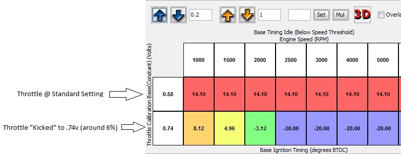

Throttle Kick
I finally got a chance to dig through the TPS code and figure some stuff out. The anti-lag that we have been using thus far has been very mild, and I believe the ROM is actually meant to be used in conjunction with a "throttle kick". Please note that I am using the term "throttle kick" in reference to locking the throttle slightly open so that more air can enter the engine when no throttle input is being applied (I am not referring to the act of actually kicking"with your foot" the throttle pedal). A throttle kick can be implemented in various ways, most often with a longer set screw. The amount of "kick" can generally vary from 5% to 15% depending on how aggressive you would like to go.
If you look at the idle timing tables and idle speed target tables you will notice they have two rows, one being .58v and one being .74v. These are slightly mislabeled as "Throttle Position Sensor (Volts)" (I have corrected the labels in the upcoming version). The parameter that these tables are actually referencing is basically the amount of "throttle kick" that has been applied, the .58v row is stock throttle position(completely closed) and the .74v row is about a 6% throttle kick(this row will be used at higher kick percentages as well). This referenced value remains constant no matter what your current TPS voltage is. So now these tables start to make a little more sense, you can see that the ECU removes timing and adjusts the idle speed target based on the amount of throttle kick that has been set in order to keep the engine from revving up due to the cracked open throttle. I have done some testing and I can tell you that with the throttle kicked open a bit the engine definitely has a more "lumpy" idle that is usually associated with rally cars. Having the throttle kicked should produce a much more aggressive ALS, I haven't done any testing yet but I will soon.
So the question is, "How do I set up a throttle kick?". Well first of all you need to decide what method you will use to keep the throttle plate cracked open. Usually you can use a longer set screw but other methods can be used as well. I will leave this up to you. Turn your key on and log TPS volts, you should "kick" the throttle open to a value between .74v(~6%) and .9v(~12%). Then you need to "calibrate" the kicked throttle. To do this is very easy, the ECU "zeros" out the throttle after reset. So to calibrate the throttle all you need to do is set up your throttle kick, then reset the ECU using learning view or the romraider logger (I used learning view). And that's it, your ECU will see your "kicked" throttle position as 0% throttle. And now (depending on if you set your kick to .74v or higher) the bottom row(.74v) of your idle timing and idle speed target tables will be used. If you decide to set your throttle back to normal you do not need to reset the ECU, just remove the kick and the ECU will "re-zero" the throttle.
In the next coming version I will also add support for a solenoid actuated kick that will automatically zero the TPS without an ECU reset. This will allow users to switch between a kicked throttle and standard throttle with the flip of a switch (with the addition of a throttle kick solenoid to the throttle body) :D

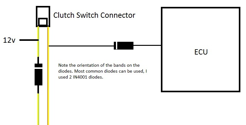

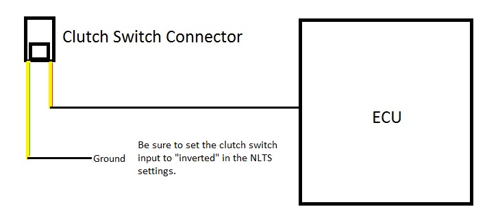

Clutch Switch Wiring
The cruise control clutch switch must be used for NLTS, this switch has a 2 wire connector with a yellow/red wire and a yellow/green wire. You can wire the switch in two methods.
A. If you don't care to retain your cruise control functionality (cruise control will be disabled with this method) you can simply snip the wires and run one from the connector to a ground and the other to the ECU input pin/wire. If you choose to wire it this way you must set the clutch switch input to "inverted" in the NLTS settings. See the diagram below.
B. If you wish to retain your cruise control you can wire it up with a 12v source and 2 diodes. This will retain cruise control functionality. Follow the diagram below for this method.
