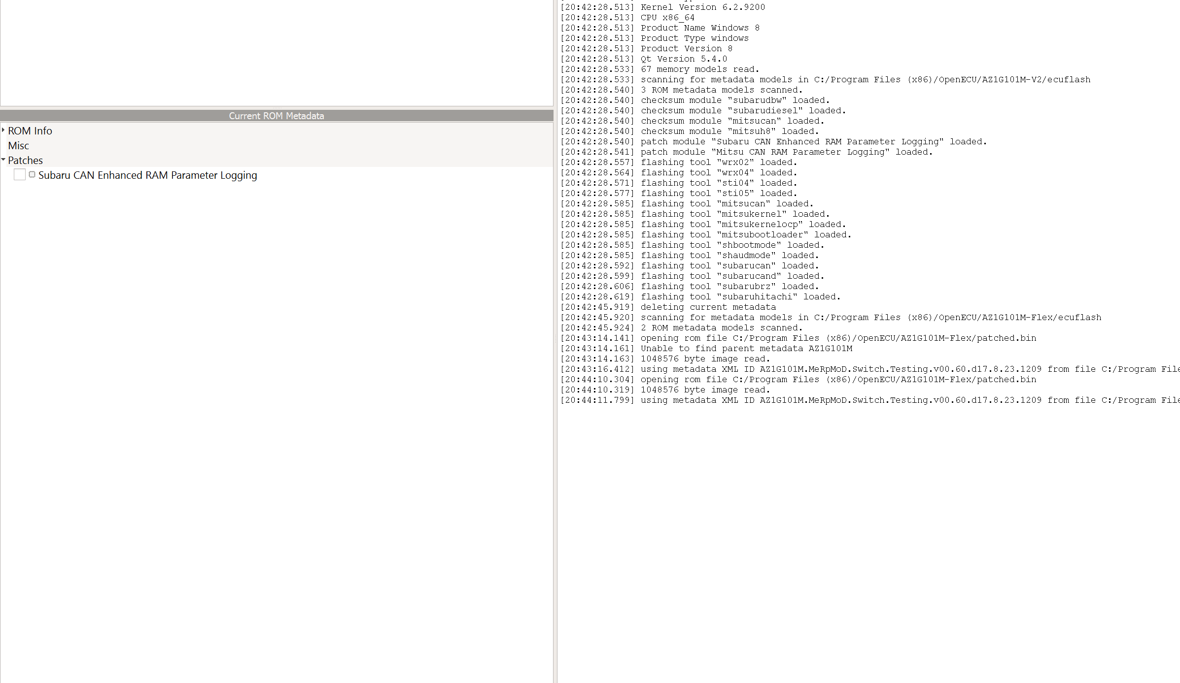

that last one loads with no tables visible?? issue with the definitions perhaps?
have you used the defs from the last zip ? each build comes with different defs unfortunately and for the last one base32.xml also has some modifications ...
Almost certain I'm doing everything right.

added the original rom from v2 to the ecuflash folder in the flex version and is opening now... not sure if that was the issue. bed time I think!

I have just overwritten my ecuflash defs with the ones from the zip and they seem ok ... rom opens ok
All good! Legend!
