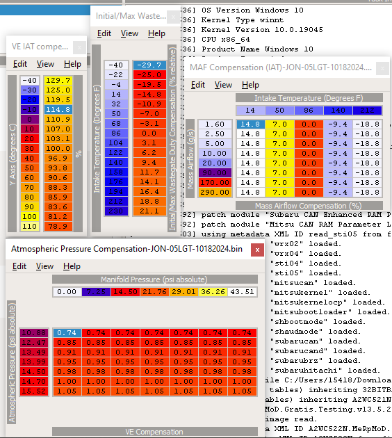

furthermore, I tried to do Pv=nRT for centered IAT of 86F and baro of 14.7, and came up *very* close to Cobb's. Eventually after testing, I made the decision that Cobb's is best.
I then also ran Pv=nRT for change in atmospheric pressure, and came up with the SD baro comp. This was initiated by vehicles that were going up 3,000 to 5,000 feet in a day and being able to send out revisions during the trips.
tested from 14.9 to 13.5 PSIa baro
also I use the inverse of Pv=nRT comp for wastegate duty. what is it that makes you need less wastegate duty at colder temps? isn't it the change in airmass?
File comment: Dime VE IAT relative to 0 compensation = 100% value, 130 value = 30% compensation, etc.
MAF IAT as appears for my latest revisions, tried to pick the most usable range for me with (the best?) picked points to try and get the most linear data between the points

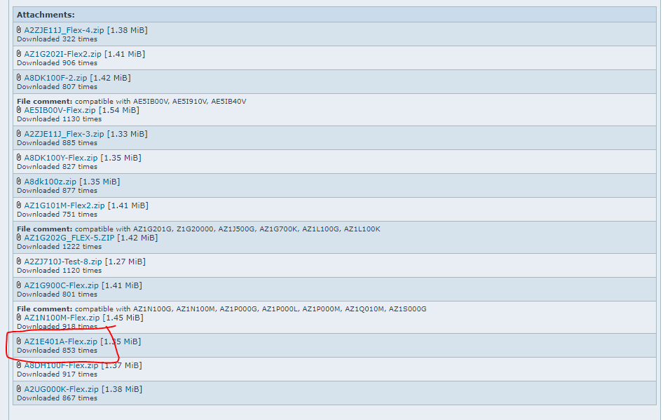

bono80kuriks wrote:
i would love to get it for my 08 usdm wrx: AZ1E401A
I'm in the middle of wiring in a jdm version 8 motor (already did version 8 trans about a year ago) and would love to get FF on the twinscroll setup :-)
+1 for AZE401A :D
USDM 08 NarrowBody "WRX"
 Post subject: Re: MerpMod Switch/flexfuel version needed by anyone ?
PostPosted: Tue Dec 24, 2024 12:25 pm
EastCoastNBWrx wrote:
+1 for AZE401A :D
first page, first comment
