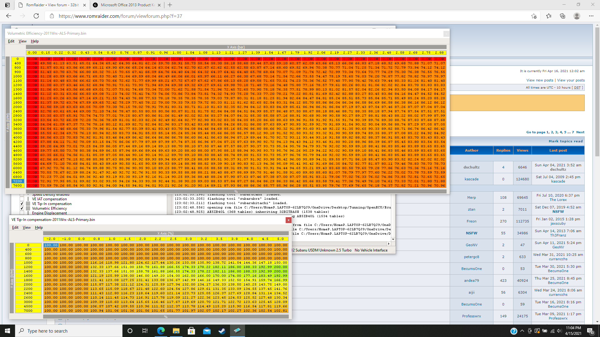

Looking for spread sheets or converters for 32x30 tables for VE and VE-Tip in

what size VE table are you converting from? what's the x/y axis size?
VE Table is 32x30, im trying to convert my current maf tune into an sd tune seems like all the spreadsheets and coverters out there only support Carberry im currently using DimeMod
2011 Wrx HatchBack - Ej255 Forged Internals - 20psi@5K - PLM Divorced Dp - Invidia Q300
 Post subject: Re: spreadsheets Or converters
PostPosted: Sat Apr 17, 2021 6:29 am
you need to log a few specific things across the entire operating range of the motor (besides manifold pressure, rpm, and manifold air temp) in order to accurately establish a VE table - you can't just take a MAF scale and make an accurate VE table from the MAF scale alone. In fact, you don't use the maf scale itself at all, you just datalog a bunch of things and do calculations on those things and plot out a table from that.
If you want to take long datalogs of specific things, i can take those and do a writeup and working example on how to properly start from scratch on a MAF based rom.
Otherwise, you're only option is to start with a VE table that is made from a very similarly set up engine that has already been scaled, and then you have to make all of the rest of the rom match regarding compensations so that it's relatively close.
Have you already invested in an air temp sensor for your manifold? (or at the very least, post intercooler/pre-throttle)
I havent got one of those sensors yet, could you point me in the direction of one?
