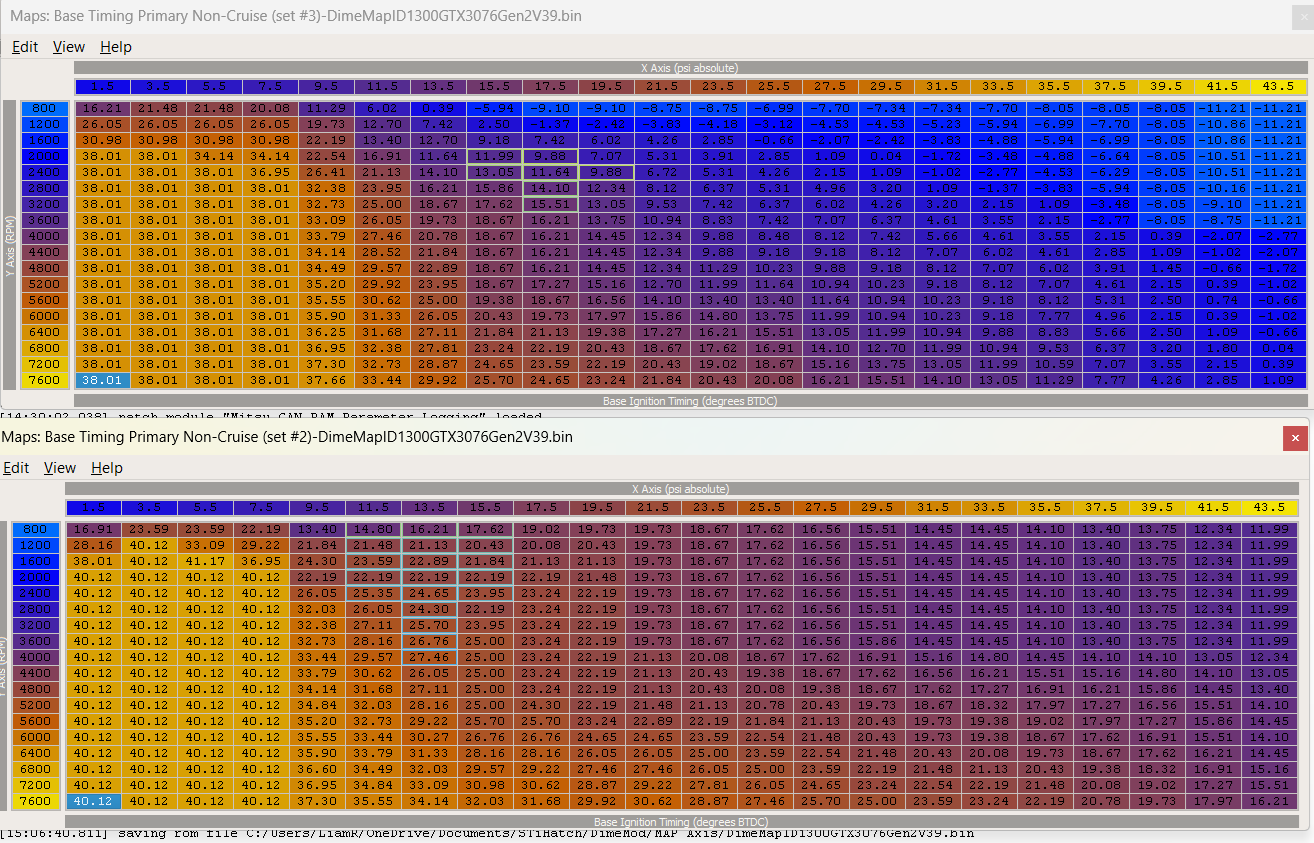

It's the man himself! Thanks so much for the reply. Since this post I've since taken the car to the beach and back, from Colorado, and I've switched the tune over to DimeMod. It was very rough at first as all my experience thus far has been Carberry/Merpmod/Haltech. Haltech is cheating its so easy compared to open source. Back on topic I've implemented your suggested AVCS Changes into my Dimemod tune and the difference is night and day. My VE map is looking more normal too; I found my fuel pump was dying when I did the Merpmod table. Car is overall very happy, but I'm busy working out more bugs now. I'm not sure where posting Dime Roms lands on the rules section. It's all self tuned but it seems Dimemod isn't super common to find on the internet :| . Also having major issues cold starting on E80 which is to be expected with the more limited flex tables compared to my last opensource tune up here on Carberry. That car had no issues down to even -10F. I've received word from Dime that he is working on adding more cold start focused E85 tables which would be invaluable in the mountains. If posting my new Dime Rom with definitions is allowed I'll throw it up here shortly once I confirm that.
