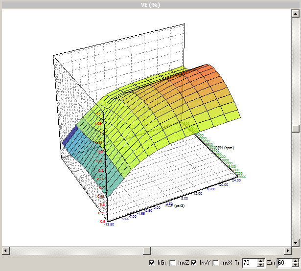

Above: My VE map as of a few days ago.
Now here's the worksheet I used to developing SD. The orange cells are intended as input.
