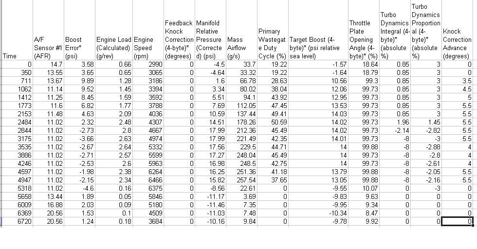

What if logged target boost is very far off from what is specified in target boost A and B tables? I see about 4-6 psi difference in my logs. I have no compensation specified for coolant and the atmospheric multiplier determination and offset are .05208 and .25 which I think are the default values. What else can adjust that target boost?
A log showing the issue: http://i241.photobucket.com/albums/ff125/truck0321/log2.jpg
I've also posted this on Nasioc: http://forums.nasioc.com/forums/showthread.php?t=1743466
I have TD integral minimum set to 0 in this map, it was set to -8 when the log was taken. I know this is dangerous and I'm treating the car accordingly.

That's a Cobb ROM dude. You can't post that on here. Read the forum rules before posting anything.
As far as why it doesn't match up, log your atmospheric pressure and post it up.

Also, what exactly are you tuning this ROM with? It is a Cobb ROM, are you using Cobb's software? If not, then your issue could be that Cobb's RT code forces the use of one of the boost tables (and initial WGDC IIRC) that are not used by the factory ECU normally and therefore not defined in RomRaider. That is, you will not be able to use RomRaider to tune target boost with a Cobb ROM.
