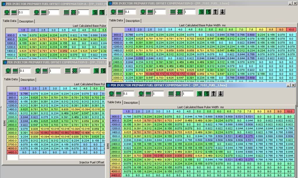

Unstable AFRs?!
I thought that I might contribute something to this. I've been running into an issue with my low pulse width AFRs where at around 1k RPM, s*** hits the fan per say. In no way am I able to obtain stable AFRs and by extension stable IDLE at this point. I've seen this strange phenomena occur while trying to tune both the SD based hacked ROM and while tuning the MAF.
Things to consider are that my injectors (JECS/NISMO) 720s run substantially lower latencies than stock. What I surmised is that the compensation tables discussed here have a much greater impact on the AFRs as the compensation values make up a greater percentage of the total pulse width.
This is bad.
Here are my tables, note that around 1k RPM, the rapid change of additional pulse width. Ignore table values, I adjusted the calculations to play nicer with my coloring.
What did I do? I zeroed out ALL 4 compensation tables. I suppose a less drastic change would have been to reduce all values by the percentage change in latency.
Results, a more stable IDLE at this point. NOT perfect, but I have yet to retune the MAF scaling at this point. Something I'll attempt tomorrow night. My exhaust note was also different, but that might have been more because of very moist air.
I'll post further results as I get em.

I just tried to work around the wall I hit at 1k RPM :( :cry: Though not as bad with these tables zeroed out its still there.
Nothing I do can fix this stumble I see at this point. Watching latency and pulse width at this transition point and it goes nuts. AFRs lean out randomly.
I checked out timing was sane at this point. Fueling points were on target. I don't think I can do anything more with the MAF scaling.
Merch/Tea, you hiding any other compensation tables at strange points like .24g/rev, 950-1.1k RPM or 1.42V MAF ?!
Is it possible for injectors to be bad at a single point in their operation?! I know this is off topic a tad, but insight would really be appreciated. The previous owner of these injectors and my flow reports reported nothing strange.

More playing with things. I have a perfect idle now. Just some MAF adjustments. I still have some weirdness at at 1k and other places. I think its just side effects of using injectors intended for larger engines. FWIW though, these injectors have done quite well all things considered for $300 :)
Meh. I'm going to max these out this summer, so I might as well pick up some 850s and not expect as much driveability as stock injectors.
Back OT, for those hitting this thread, zeroing out this table can help with stable fueling for non stock injectors :)
