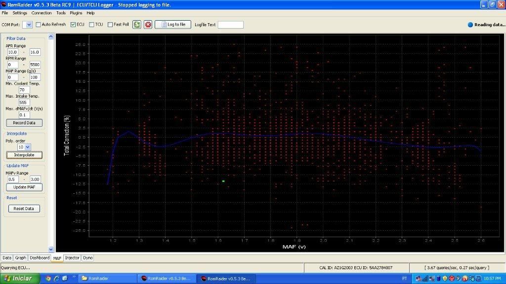

Guys,
Yes, I know how to do this but have no idea about hex code / decoding / address / ECT.
I wanted to let everyone know, I have been looking for a universal solution to this since 09. I have 100's of hours into research and development for the GR hesitation. I problably have 75-100 GR's running around in the US/Canada/SA. Most have slim hesitation with hours of logging as well as trial and error.
This SADM car :
Its an 08 STi. The fuel system is completely custom. There is a tank, 300lph pump, an external surge tank, 3 parallel 180lph pumps, a 65lb/min turbo, and ID2200s flowing straight E100 ( along with lines and rails). I figured this would kill any possibility of the typical studders and bumps.
Well, it did not.
BUT THESE NEW TABLES DID!!!!!!!!!!!!!!!!!
I have alot of maps to get out now, lol.
I need to know who to donate to. Money is in paypal ready to go.
Also, any address for the 2011 USDM STi. I have tuned a few dozen, but have 2 or 3 with hesitations I couldnt shake off that well.
Thanks so much, incredible!!!
-Mikey

Go enable fast poll (located just on the left side of connect/refresh and disconnect). This will enable rr logger to get samples as much as 20 plus queries/sec. Its gonna speed up what you're doing for maf scaling! :-)
STi Mikey wrote:
MFB wrote:
Here's the Paypal Donation link for Romraider.
https://www.paypal.com/cgi-bin/webscr?cmd=_s-xclick&hosted_button_id=NNMFL8N43DUBQ
What values did you end up using for fuel pump duty? How are the trims in close loop now?
66/100
More work to do!
