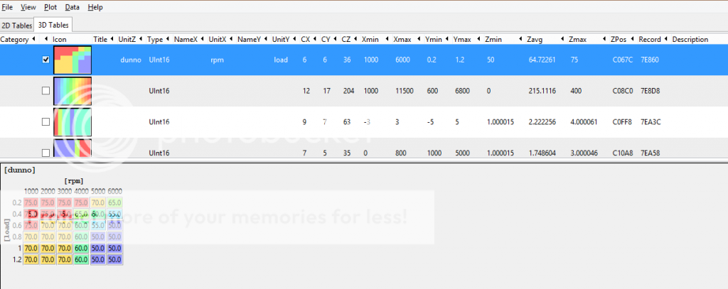

Does anyone know what the first 3d table that pops up in ScoobyRom is?
It seems to be the same on every 4 cylinder turbo and 6 cylinder but different for 4 cylinder Non-Turbo.
Every time i see if it bugs me.
A8DH100M

AF Sensor Heating Limit, RPM vs. Engine load axes. Part of the logic that protects the AF sensor with respect to duty cycle.
Not currently defined - unless you download the 32bitbase.xml that I recently posted up on my Github branch ;)
If you want to get an idea of the full range of Alpha parameters, download AZ1G202G as well for Ecuflash.
