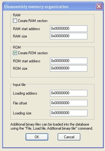

Please let me know if you want me to take some of these screen shots down if you find that they do more to confuse your thread.
While I'm at it and for others to see, I should select the Hitachi SH4B instruction set? ;)
For the usdm STi rom you reference in the first post, how do you find the ROM start address? I bring this up as the first screen upon opening up a ROM asks for this. Is this also the same screen to add the RAM segment?
After loading the STi ROM, I highlighted ROM addresses 00004000 though 00007000 and hit the 'c' key to start the auto code analysis. IDA went ape for a while and the "blue" bar up top appeared much as you said it would by walking the code pressing the 'o' key.

Start address is always 0x0. End address is defined by the size. You never need to touch that, IDA fills it out for you.
You can get the start and stop or size of RAM from the 7055 or 7058 Renesas manuals, along with other segments.
You want to select SH 4B. It includes all the instructions in the CPUs we are looking at.
