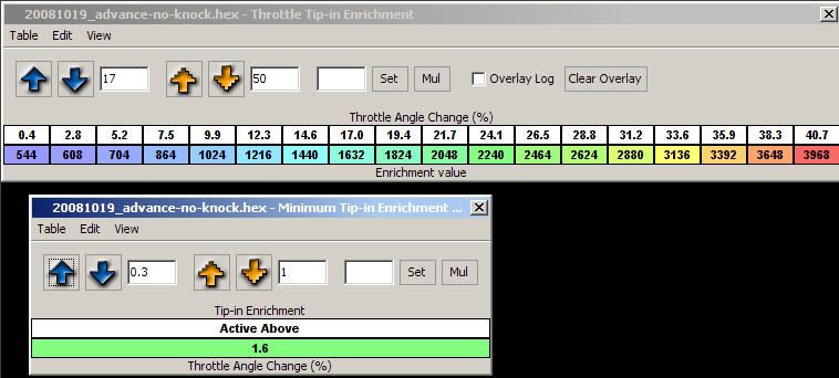

I've a question regarding my tip in tables:
Since my tip-in enrichment is active above 1.4 only, why is the minimum value set so low to 0.4 in my throttle tip-in enrichment is 0.4 and the next value is 2.8?
Also, what's the implications if I were to change the tip-in enrichment is active above 0.4?

If you touch the throttle less than 1.6% per unit time, it won't trigger the tip-in throttle spray at all. It skips using the tip in map altogether.
Once you get 1.6%, then it uses whatever value from the map. It would be a weighted average between the 0.4 and 2.8 columns.
