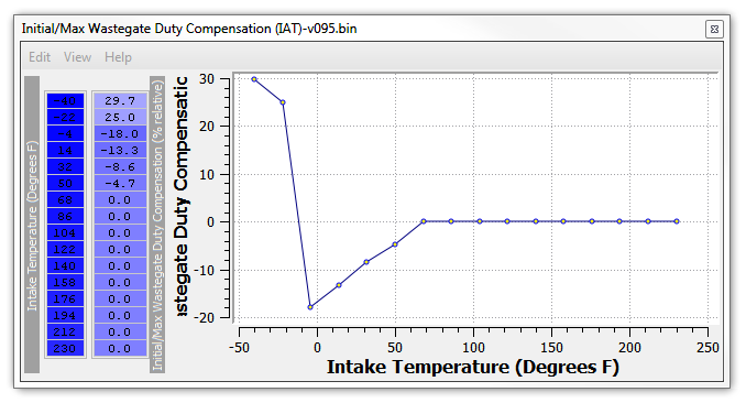

Merchgod, is there any chance that the definition for this table is just "off" by a couple values?
This screenshot is from EcuFlash with the latest definitions.

I don't get that when viewing it on my machine. Might be that someone modified the cal id of the ROM you are viewing?
Ecuflash 1.42, A2WC510N latest standard units Ecuflash definitions (I even DL'd them again to make sure I wasn't using a different local copy):

False alarm, this was self-inflicted. :shock:
The original ROM for my car doesn't have this problem. I just found the revision of my ROM where this table changed, and my notes indicate that I was tinkering with WGDC around that time. My guess is that I intended to extend that compensation further down to the left and somehow managed to screw it up royally.
