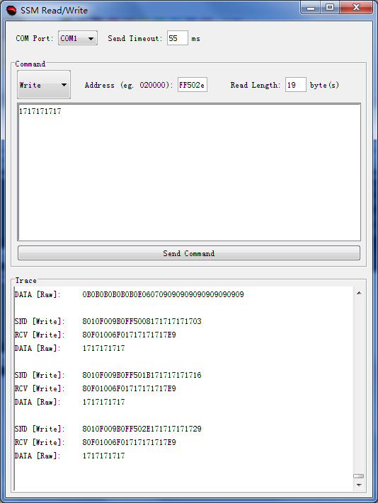

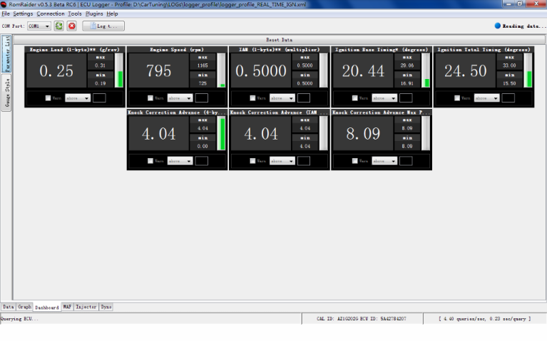

Yeah, succeeded!
I'm so sleepy now so I do a quick post and explain later.
The testing rom is a stock AZ1G202G(from edm 08 sti).
I changed the KCA table data address to 0xFFFF5008, it is a static patch. The ECU reads KCA table from RAM address 0xFFFF5008 now.
Then I hooked the MaybeGetKnockCorrectionAdvance function address, and jump to my code to copy KCA table data to a block of free(maybe) memory 0xFFFF5008. My code runs only once by checking and setting a magic number at 0xFFFF5000.
Then I used SSM Test App in RomRaider to change the KCA data at 0xFFFF5008 when the car is running, yeah, it works, see the picture, the changed KCA kicks in at a very low rpm and load range, and effects the total timing.
Now two problems need to be done:
1. A table based front end is needed for easier tuning.
2. I have no idea about the RAM checksum for now, so the ECU will sweep the memory every ignition on, then an original KCA table will be copied from rom to ram every time. Downloading a whole timing table everytime is somewhat bothersome.
