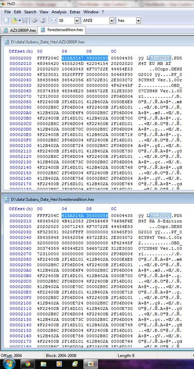

AE5K500V is actually at 00002004(2004), the top row defines the final integer in the cell address
It now takes me around 3 to 5 hours to define all the common 2D and 3D tables, along with most of the single cell values as well. I know what I am looking for in finding the length of X axis values(say 12 values long), then the Y Axis values(say 12 values) then I know I have a 144 value long Z value. You will notice I use a comparison between a known ROM and the new ROM.
Can I also suggest, in HxD going to View> Bytes per row and change to 16 then View>Byte Group Size> choosing 4 as the 4 byte will make it much easier to see the values(and looks more like my posted picture)
To find the Ecu ID, use HxD and search for: F3FAC9(as a Hex Value, not Text String) which should be in the D3D00 region of the ROM and the Ecu ID will be the 10 values prior in Hex and will have 07 in front of the F3FAC9
For example, the Forester S Edition one I did was: 71325140 07F3FAC9 with the Ecu ID being 7132514007
Really comes down to what method you are comfortable with, I can handle Hex as I use it at work a fair bit
As an example:
Copy 3F660000 3F700000 3F7A0000 3F820000 and then do a HxD search, past in the values and do a Hex Search. It should be in the D3400 region and where ever the 3F8C8884 value appears(ie D3400, D3404, D3408 or D340C) is where the start of the MAF Scaling is. Then use 3F8C8884 3FA21A01 3FB9E4B0 3FD408EA to find the Storage Address
Forester S Edition one was:

Throttlehappy: Where did you come up with the F3FAC9? Or is that just knowing where the ecuID would be from previous definitions?
When you say define the table 3d and 3d and even even the singles... Are you actually defining what each table is? Or are you just going through fidning which table is which? IE this is a 3d table since I see its 12x12 or 144 long so I will define it as such... Then when you can view the table in romraider is when you label what each table is...
Thanks for the hint on the hex editor... Searched F3FAC9 and found 11 81125950 ... However it was in the d9d10... attached is a screen shot...
dschultz: I did not post the rom since I wasnt making a request to have a definition written... However if you want to take a look I have attached it here (it is a stock 2012 sti sedan USDM rom)... If you would like I can make another post with the stock rom and request for the definition... However there is not huge rush. I have not seen anyone else make a request for this rom...
EDIT: Wow my screen shots are horrible... Is there a ss option in hxd that im missing? After I print screen and scale the image to upload it becomes to distorted for any use..

Ill have to go through the readme... It looks as though it will define the tables and you can export them into an xml... Then I guess its up to us to determine whats what...
From the looks of it that would save us (throttlehappy) about 3-5 hours of table consolidation into 2d and 3d sections right?
I wonder it there is a trial version of IDA somewhere...
