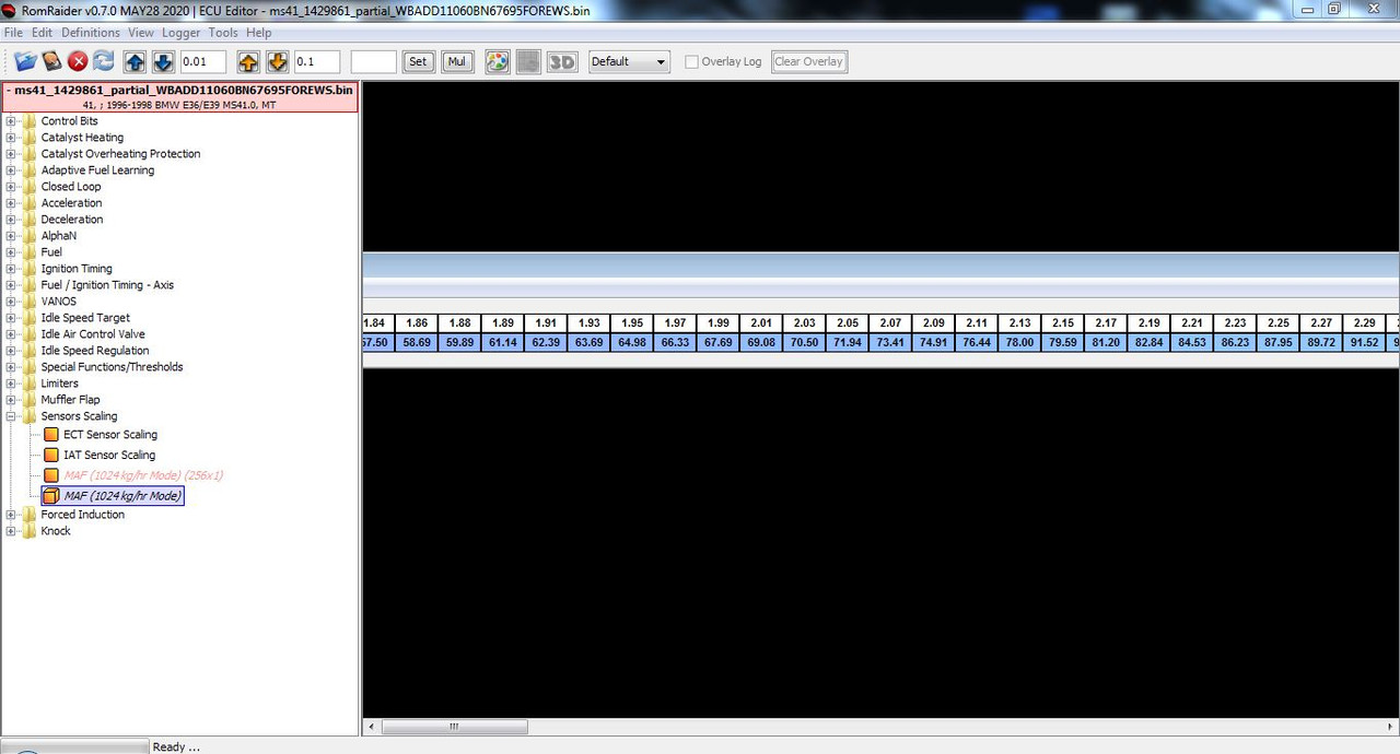

Hello, first thank you for all info here you guys are awesome.
I am planing to do 2048 MAF mode on 1429861 ID41 ECU 2.8i
When I load full bin in RR I dont have 2048 mode, but...
I did 2048 mode on M3 file and I see that only one byte is changed
So I compare that to my 2.8i file and look like I only need to change in my 2.8i file
42 to 32 at 0X28621
Will that work? Also do I need to checksum 256 binary after this?

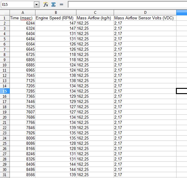

 Post subject: Re: MAF Limit = 2048 kg/hr
PostPosted: Mon Jun 20, 2022 7:28 pm
Joined: Sun May 22, 2022 1:59 pm
Posts: 51
I can confirm that this what I mention post before work. At least at bench I don't have car to test it
But you can see from log that at 2.17 V I have 160 kg/h. In my map is around 80 what is half of this value
Thank you all guys you are awesome

But also there is no reason to do MAF hack, beacuse load limit on MS41 is around 1050 mg/str. And you will most reach first load limit before MAF limit. Unless engine revs 1000-2000 rpm more than stock. But for turbo, MAF hack does not have sense.
If anyone have some IDA project for MS41 I can help find Load limits to divide them
