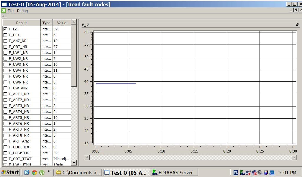

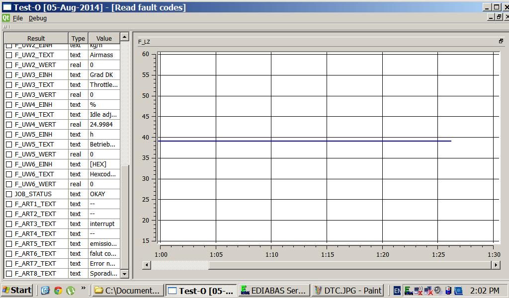

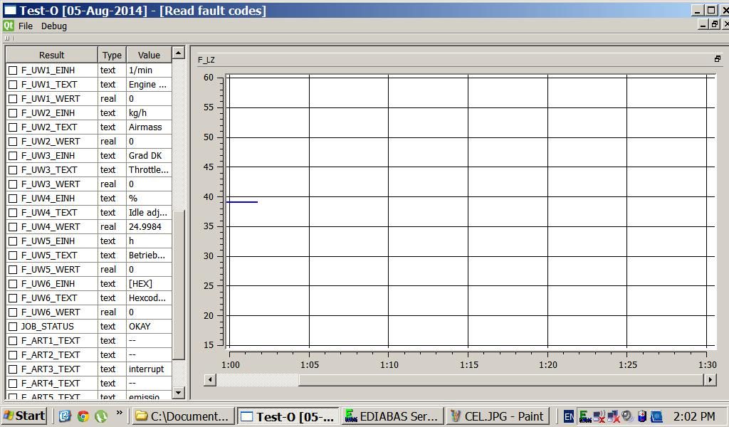

Hi Pheno, these are some screen shots I took of what happens when I check the DTCs in Testo
http://i67.photobucket.com/albums/h309/ ... g~original
I'm not really sure what to make of all that data on the side.
I don't want to run this engine any more than is necessary. Instead of spark coils I will be going for the TPS and attempt to make a TPS error show up as something else.
Thanks, appreciate it. What we are seeing here is EDIABAS "translating" bytes what ecu has sent into resultnames and values. How these are mapped into OBD2 codes, I don't know.
You don't have to run the engine to read the codes I believe. Reason I asked to run a trace is that from the tracefile you can see what bytes ecu has sent and how EDIABAS has resolved them into resultnames/values.
