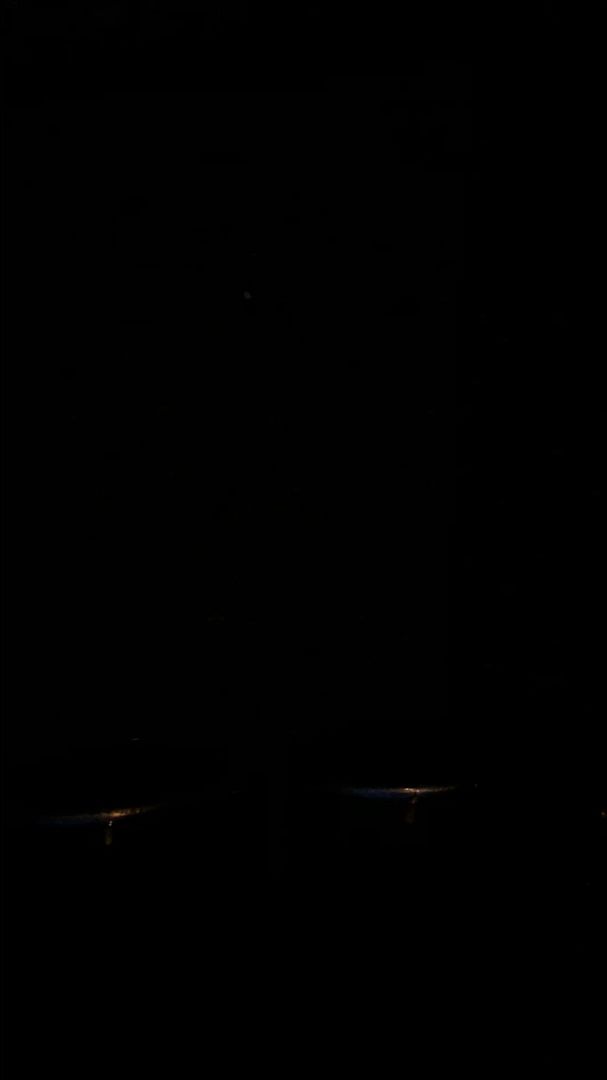

 Post subject: Re: Deceleration
PostPosted: Mon Jul 24, 2017 2:41 pm
Joined: Tue Jan 24, 2017 7:58 am
Posts: 478
This is a vid running the setting i was discussing with buster on page 13-14 , still no pops or bangs when moving until i get down to roughly 4krpm, I have added fuel in the lowest load table in base fuel from 7k to 3800rpm as the lowest load is where it sits on decel and here are the results, why can i get the decel tabels to do more?
EDIT>>>VIDEO WILL NOT WORK, RR WILL NOT ALLOW ME TO ATTACHED MOV FILE DIRECTLY EITHER, SORRY GUYS :(
PostPosted: Wed Jul 26, 2017 2:13 am
Joined: Wed Oct 21, 2015 2:36 am
Posts: 980
Ditch photobucket and host your videos on youtube
PostPosted: Wed Jul 26, 2017 3:34 am
Posts: 478
Ok, So here is a link to my video, this is what i have so far. :)
https://www.youtube.com/watch?v=dxjhKrd ... e=youtu.be
