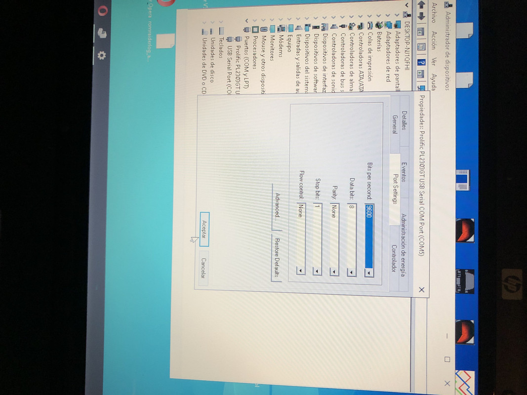

hello first of all apologize for my english. I am Spanish and I don't get along with the language :)
I can't get the RR loger to read me the AEM AFR connected through the COM port
I use the puggin but it still doesn't work. In the aem marker, if you see the port, it is well configured as the manufacturer marks.
What could be what I am doing wrong any idea? Thank you very much in advance

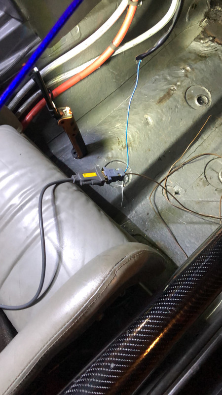

problem solved. the manual tells you to connect one way. but it does not say anything about whether the connector is female or male. my cable connector to pc is male. but of the aem it is female. I leave a picture of how it should go
thank you very much for the help friends :)

glad u solved it. never thought of that obvious connector type difference....its usually the stupid things that get u...
