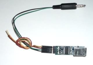

Any TTL-level serial-to-USB converted can translate from the PLX SM-series sensor signal to any computer. There are several available on the market, and I suggest using Pololu's PL2102-based converter.
My first attempt used a converted from Acroname adapter, and looked like this:
For some reason, Photobucket won't let me upload a picture of the Pololu adapter. But you can find one on their site here: http://www.pololu.com/picture/view/0J75 - after you make two solder connections to it, it will look similar to the picture above, just a little smaller.

  • From Radio Shack, get a headphone plug that's the same size as the SM-AFR cables. I think it's 1/8" but I don't remember exactly. Make sure you get the stereo version, which has a tip/ring/sleeve configuration. A mono plug will only have the tip and sleeve. Basically if you find something that looks like the picture above and appears to be the right size, you've got what you need. If I recall correctly, a package of 2 cost about $5.

  • The headphone plug comes apart if you twist. The plastic jacket comes off, and that exposes the surfaces to which you can solder the wires. If you stare at it for a minute, it should become clear which surface connects to the "tip" of the plug, which connects to the "ring" (ignore that one). The big metal arm connects to the "sleeve" of the plug.
  • For the Acroname adapter, plug the wiring bundle into the adaptor as shown in the picture above. Pay close attention to which way the adaptor is oriented and where color wires are connected in which positions. Cut off the connector at the other end of the wires. Now you have four loose wires. Tie two of the wires it a knot around the others to get them out of the way (again, see the picture above).
    For the Pololu Adapter, just locate the 'ground' and 'Rx' thru-holes on the edge of the adapter. You'll have to supply your own wires. Solder a black wire to ground, and a non-black wire to the 'Rx' thru-hole.
  • Solder the black wire to the ground tab on the headphone jack.*
  • Solder the signal wire to the tab that goes to the tip of the headphone jack.*
  • Slide the jacket up the wires to the headphone plug, then screw the jacket and the plug back together.

  • Open Windows' "Device Manager" and expand the "COM and LPT ports" section.
  • Memorize what you see. There will be a test.
  • Plug the USB cable between the adaptor and your laptop. You should get some messages about finding and installing device drivers, and then "Your new hardware is ready to use."
  • Back in Windows' "Device Manager" there should be a new COM port visible.
  • Insert the headphone plug into the serial output jack on the SM-AFR.
  • If there is black smoke and/or fire, return to step 1. This however is extremely unlikely. You only made two solder connections, and one of them is ground, and the other carries a negligible amount of current. Like, damn near none at all.
  • Run the PlxTest.exe utility that I will attach to this thread real soon now. You need to specify the name of the COM port when you run it, e.g. "PlxTest.exe COM5"
  • You should see a stream of numbers that like AFRs, between the mid 14s and low 15s.
  • Success? If not, post, and I'll see what I can do. Please include pictures.
* These steps are more tedious than they sound at first. You need steady hands. It helps if you have three hands, or at least something you can use to hold the wire and plug steady while you apply heat and solder.
