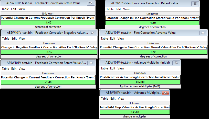

I then put my ROM image I have saved on the computer into RR using this newly modified def file, and I got the value from that address in the newly added table. But the value is again -1.4 degrees.
So no matter what I do, I can't find -1.5 degree value defined anywhere ... But I think this "preemptive" concept is definitely what I am seeing in my logs. I am just curious as to why I can't find the "source" of it anywhere in defined tables.
I am not yet confident enough in my RR understanding to be making actual changes to the ROM, and flashing them. So this is part of my learning process. It is not that I am not confident about LTV, but when I see inconsistencies I want to learn as much as possible about their causes :oops:
 Post subject: Re: Definition request AE5W101V
PostPosted: Sun Dec 16, 2018 10:04 am
Posts: 7314
Do you have a correction value of 0.5 set somewhere? Three of these = 1.5. The logger may not be fast enough to catch three events in succession.

As far as I can tell, 0.5 value is only related to IAM. See image.

      <description>These are the airflow ranges in which the different long-term fuel trims are calculated in closed loop and applied to the same airflow ranges for both closed loop and open loop.</description>
Car still runs great, even though I still get some FLKC of up to -1.4 in the load/RPM range as caught on the second screenshot - so I am inclined to think this is more my commute-style driving than anything really wrong with the car. I will continue to monitor it and see how it goes when we get out of the cold winter. This is the same area in the map where base timing is already set for -41 degree or so.
