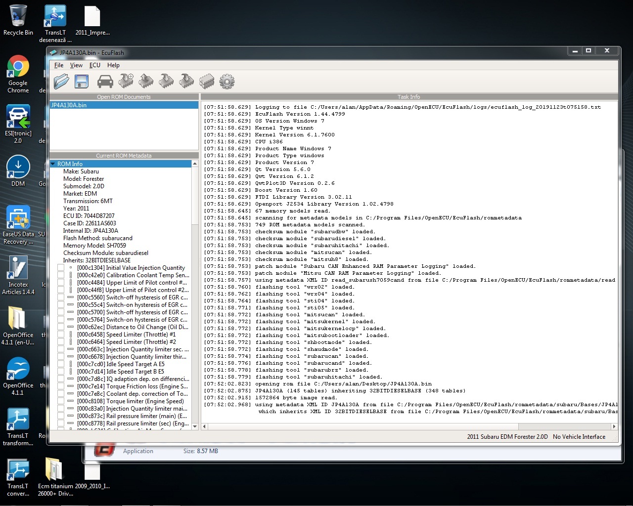

Hello! I have 2 quenstions, if somebody can help me, you can tune directly in ecuflash, how is in tht picture, and JP4A100A can be changed with JP4A130A, without any changes, just write with ecuflash and thre is no problem, and if i change maps on this JP4A130A, ecuflash check checksum or i have to do it with other programs?
Yes, checksumms will be corrected and you can wirte dump to ECU after chancing..
Yes..
ECUflash will do the job
