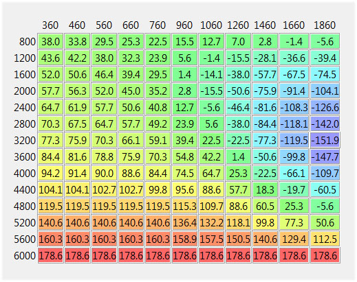

Not real results to speak of, but working on that. I'm working on the assumption (yes) that decreasing the values in Table 1 will shift the injection end point earlier. I'm starting by rescaling the table to suit my loads and boost pressures and reducing by 10* (or as close as possible) and going back to zero (whatever that is) at 2k4rpm, where I'm not having problems. This seems to make things a little better. LTFTs so far seem unaffected. The test will come when I try again to reduce my tip-in enrichment and see if the bogging comes back.
