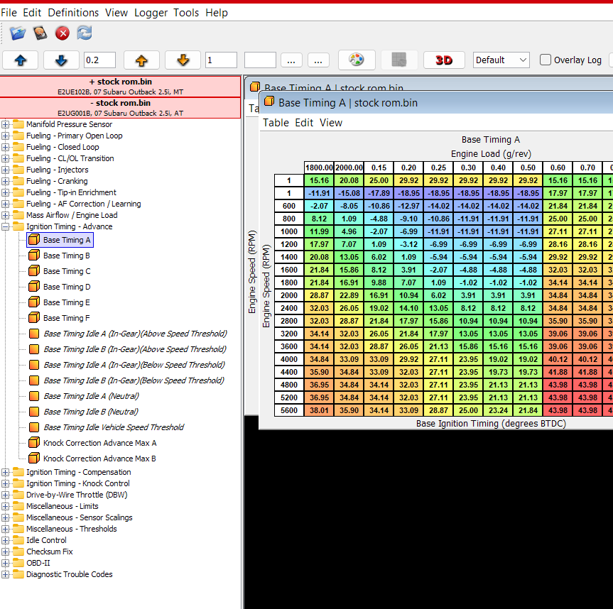

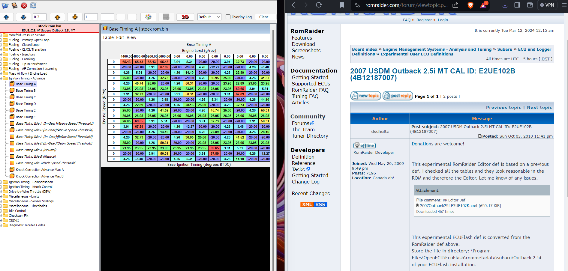

I have tried to use both RRdefs and ecu flashdefs: E2UE102B and E2UG001B and others with no luck. I am new to opensource but I believe I am doing everything right (i could have missed a step);
downloaded latest ecuflash/romraider, pulled stock rom with an openport 2.0 and saved as a bin, installed the latests definitions for RR/ecuflash (including adding experimental defs manually) opened the stock bin file on romraider and opened various defs.
I am no expert but when i opened the different defs in RR, the tables look strange for almost every parameter. as seen in pictures.
I dont know what i am doing wrong :(

File comment: first def (E2UE102B)
File comment: second def (E2UG001B)
