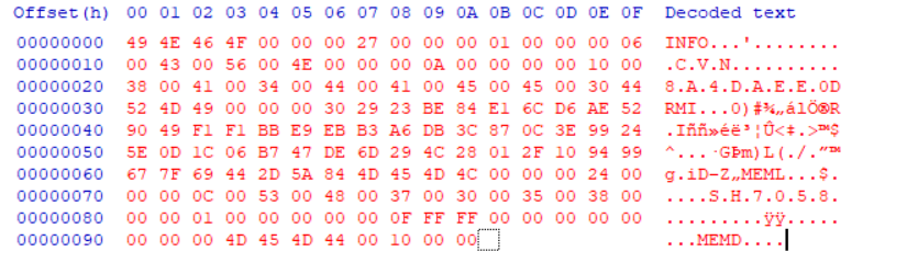

That ROM is actually a renamed .SRF file, which adds 155 bytes of metadata at the start. You’ll need to strip that header before ScoobyRom can parse it correctly.
Once removed, the ROM loads as expected. I’ve attached a quick output from a hex viewer showing the SRF padding in case it helps.
File comment: 155 bytes of data
