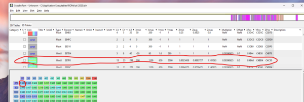

I'm looking at the engine load compensation table information in ScoobyRom for a 2020 STI and I see it has a multiplier of 0.00390625 and an offset of 0.5 with a first value in the table of 0.93

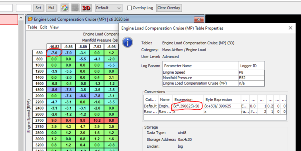

RR is using a scaling expression of (x*.390625)-50 and has a first value in the table of -7.0
Shouldn't the scaling expression be (X*.00390625)+.5 ? I'm trying to understand why the scaling expression in RR is different than this. When I calculate the expression using the RR equation, I do not get a value of -7.0. This is my first time looking at ScoobyRom and scaling and I'm just trying to learn/understand.

Which CAL ID?
Most likely the definition is wrong and it should be as you indicate.

Which CAL ID?
The CAL ID is AE5Z500V.
