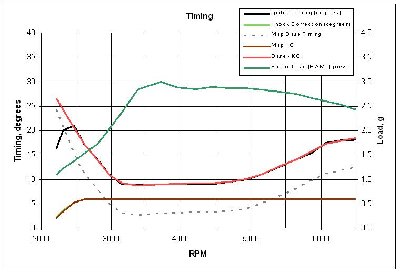

Everytime I do the timing interpolation, it keeps ploting my Ignition Timing Advance as my actual ignition timing? Is this correct?
IS this an error. I couldn't even begin to disassemble this awesome spreadsheet. I don't understand anythign about programming...but it beats printouts and plotting by hand, that is for sure.
Thanks guys!!
Make sure you have the data copied in correctly from your base and advance map. Also double check the boxes for the correct logged parameters. Everything whould work correctly when done and look something like this.
File comment: Example
