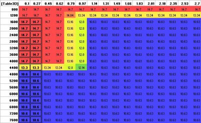

Airboy...
For some reason the overlay / Interpolation function isn't working for me...???
I need this to work, so that I can determine targeted AFR's...
Is it an issue with the spreadsheet, or perhaps something to do with me...
Can someone please test the interpolate function, and see if an overlay is shown...
This is what I'm getting...see attached...

Phoenix wrote:
Airboy...
Post your log file.

Post your log file.
I actually managed to come right...
For some reason, if I select the calculated load button, in the data tab, after importing a csv file...then I have issues interpolating data...hmmm...weird...what you think Airboy...???
If I don't select 'Calculate Load'...then it works fine!

Phoenix wrote:
Post your log file.
The "Calculate Load" button is only needed if you didn't log Engine Load and only MAF(g/s). You probably logged both MAF(g/s) and MAF(v). The list box under the Calculate Load button shows which data column it is using to calculate Engine Load. It is likely highlighting the MAF(v) data, which is not the correct item.

Aaaaah...makes sense now Airboy...
Thanks bud! :wink:

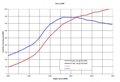

I have been trying to use the dyno function with my AEM Standalone logs to no avail :( Any help Airboy et al? I'd really like to know the trick if someone is able to make it successfully work.
Here's the relevant info I think:
2004 WRX Wagon
2006 STi 6MT
Pulls done in 4th Gear
Tire Size: 225/45/17
Extra weight = 275 lbs
Thanks!!

The problem is that the resolution is too high.
If you move the charts around, you can see the equations in the cells. Take a look at the equations in column E. The rough acceleration is calculated first. It is calculated based upon just two rows of data. Since your resolution is super high, the difference between the two rows is too small to calculate a decent slope.
What I did was filter your data and only grabbed every tenth data point and I also multiplied the time by 1000 to convert to milliseconds.
What we really need to do is to rewrite the internal EXCEL slope function.

I ran the data through and it worked "ok" with the max filter value of 10. You have to extend the graph range from ~200 rows to 600 rows to cover all of your data. Don't forget to filter the WOT data on the first page.
Looks like AEM spits out data at 20ms intervals but the actual data doesn't have that time resolution (repeated values).
You can increase the filter value by:
-click on the cell for Smoothing Factor
-go to the menu bar under Data, select "Validation..."
-in the window that pops up, there should be a box for "Source" that lists 3,4,5,6,7,8,9,10
-add one or more values to the end (e.g. 16, 20)
Now you should be able to select smoothing factor or 16 or 20. Re-run the macro and it should look like this:
The above instructions are for Excel 2003, the menus are likely different in Excel 2007 but if you search for "validation" it should show you where it is hiding.

Added those as well at 24, which seems to work well. Thank you guys very much for all of the help!
