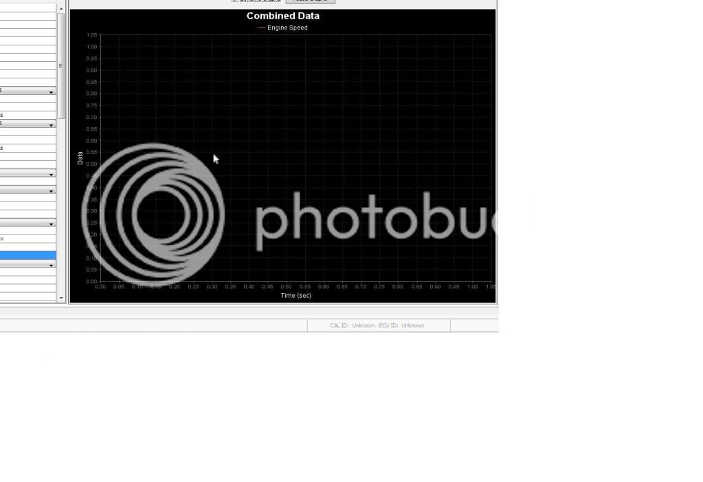

A couple ideas on changes that would make the logger more user friendly:
On the MAF scaler tab-
*Having a spot that tells you if you are in open loop or closed loop would be helpful, a simple spot to put the number would even work (8 for closed loop in my car, 10 for open loop)
On the graph page-
*Being able to select the line color would be a nice feature manually instead of changing it each time u click a new parameter
*If you pause the graph page and leave your cursor in one spot for more than a couple seconds it would be nice to have a small box pop up with the data, for example-
There would be a box pop up with .55 by the cursor in this picture^
Having an easy way to configure the 0-5 volt scaling of the TGV sensor wires in Romraider would be a nice feature as well.
I'm sure there's a few other things I can think of that may help. I'll report back.
