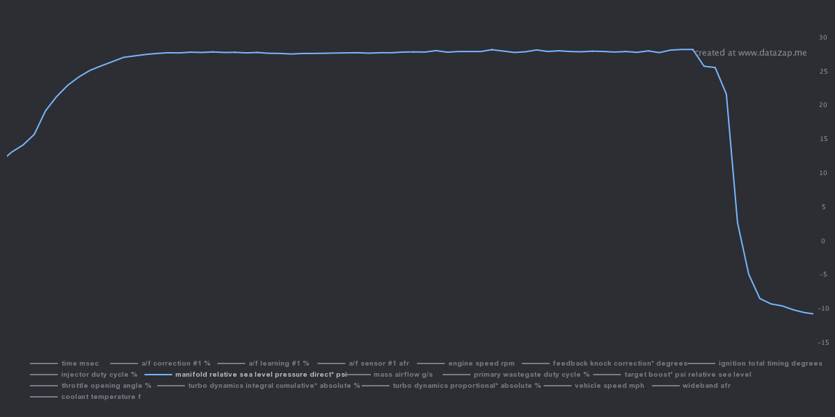

PostPosted: Mon Aug 28, 2017 10:50 am
Joined: Mon Nov 30, 2015 6:31 pm
Posts: 482
Location: Pittsburgh PA
boost curves flat as a table
http://datazap.me/u/terryjr/drag-night? ... oom=88-163
Exotruck - CarBerry 4.2 - Closed deck hybrid - 580whp on E75
 Post subject: Re: Possible to change frequency of pwm feeding ebcs?????
PostPosted: Mon Aug 28, 2017 11:21 am
Joined: Fri Sep 02, 2016 8:42 am
Posts: 514
Location: Riga, Latvia
So what did you end up with?
PostPosted: Mon Aug 28, 2017 6:42 pm
Posts: 482
I made a boost controller with a Corksport EBC housing and a MAC bullet valve BV314A-CC1-00-BCKA-CBA. Its pretty much a Perrin PRO or standard Corksport. I'm running it at 20hz and the ewg is using both ports. With a 18psi spring, im hitting 29psi at ~10% duty cycle, .25% TDI and its within 1psi of target to redline with no spiking and NO FLUTTER. The bullet valve is handling the low duty cycle much better than the standard 3 port
https://youtu.be/ye377UO5-LE
