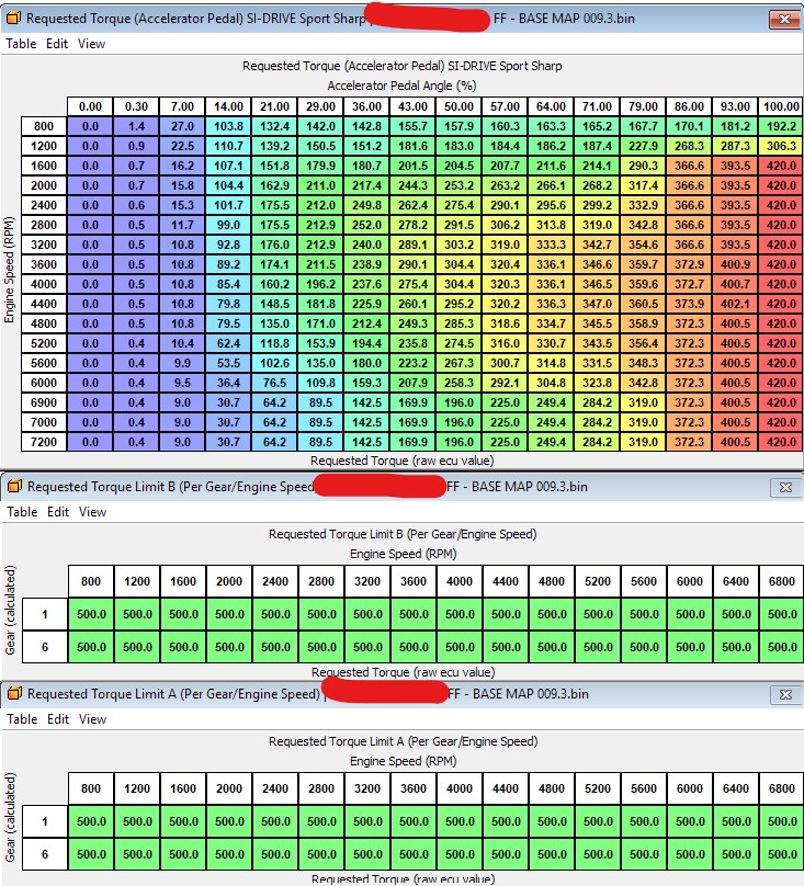

I have a situation where i have my requested torque for sport # calling for 420 but its only going to ~300 or ~350
https://datazap.me/u/subbienoobie/log-1 ... data=16-35
Does anyone know what would be causing this ?

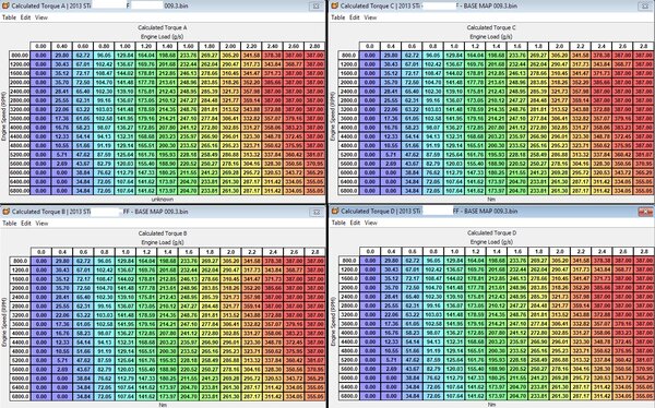

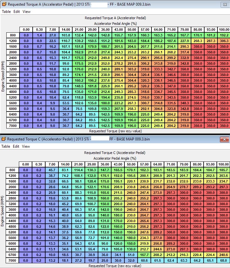

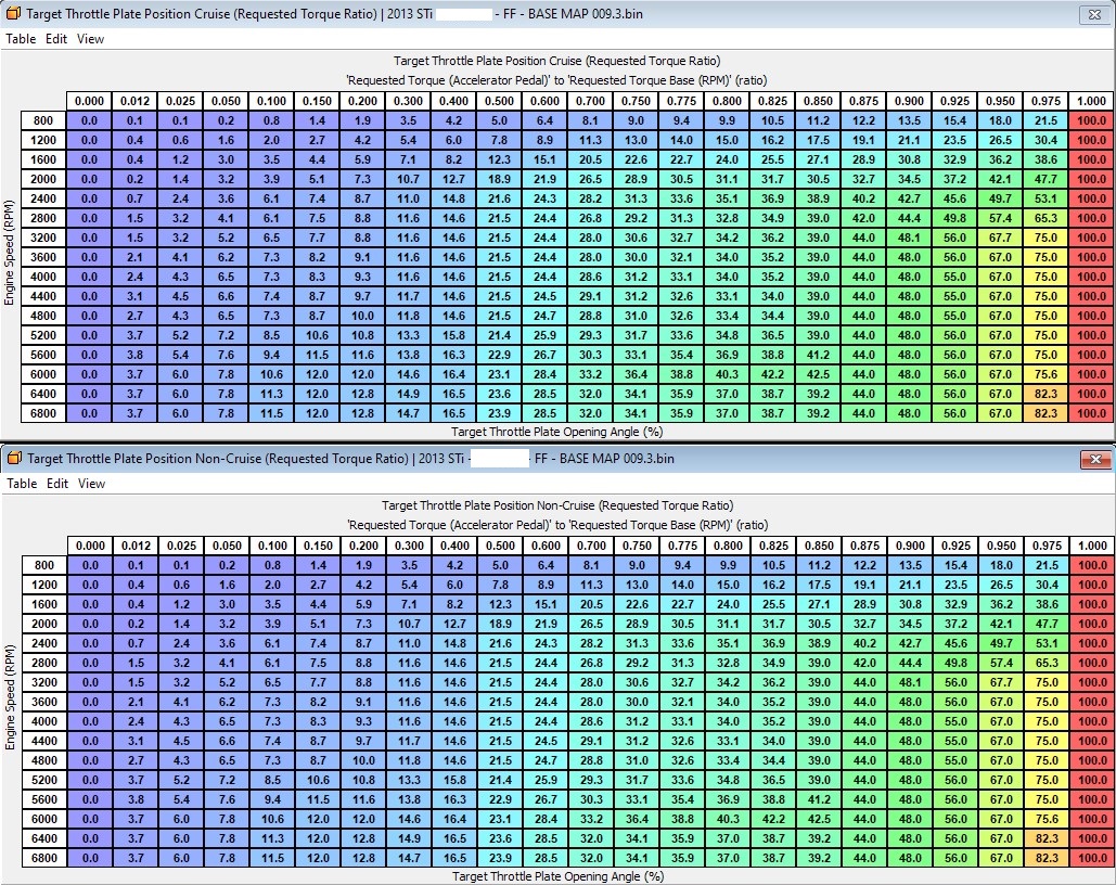

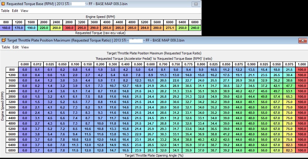

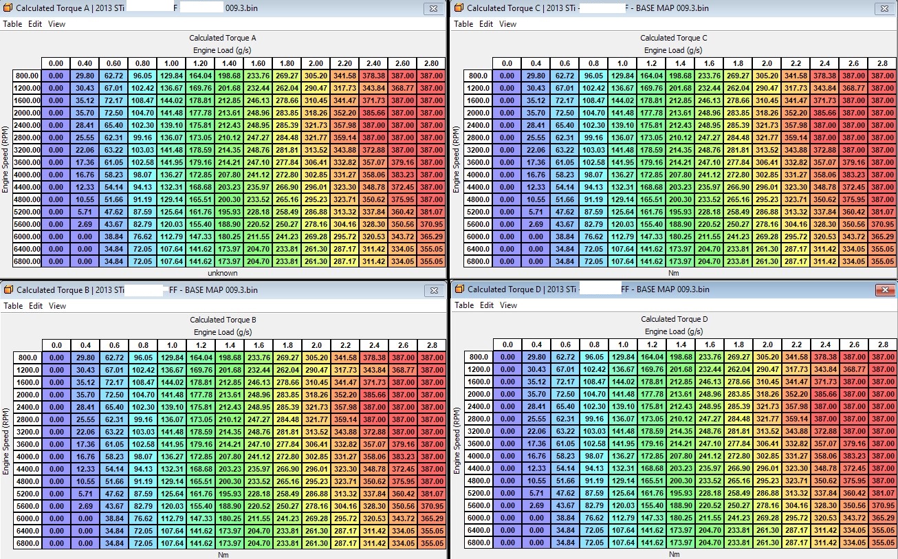

For Reference here's more of the tables... I'm not even sure what the Calculated torque one does...
I think that's the one to do with traction control but not 100% sure
Regardless similar behavior with traction control on and off
